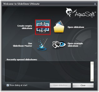

At first you have to specify the aspect ratio you want to create your slideshow in. The aspect ratio defines the ratio between image width and image height.
Dlg_Welcome_Format_i
If you want to show your slideshow on TV later the aspect ratios of 4:3 and 16:9 come in handy. Older CRT-TVs only support the ratio of 4:3, while modern flat-panel TVs support both 4:3 and 16:9.
4_316_9
If your images are in format 4:3 or 3:2 (digital single-lens reflex cameras) select 4:3 as aspect ratio.
If they are in 16:9 format select this format respectively.

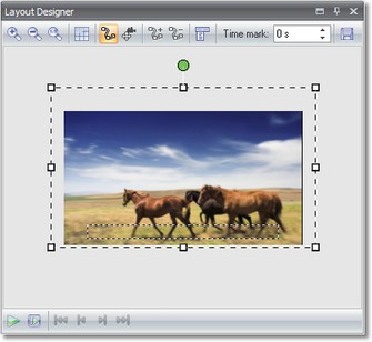

You see the black borders left and right of the image.
Decrease the size of the visible area in Layout Designer by clicking on the LABr_ZoomOuticon. Now increase the size of the image by dragging the handles at the corners of the position frame until the black borders disappear. At last position the desired area of the image in the visible area.
Now it should look similar to the next graphic:
LA_Image_16_9_stretched

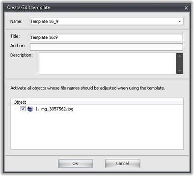

You can save this positioning to a template so that you don't have to repeat this process for every single image. To do this simply drag the image from the  Image list to the Toolbox and specify a name for the template in the now opening dialog.
Preset_16_9

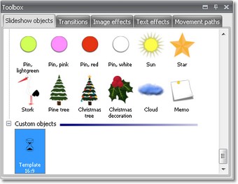

After clicking OK you can find the template in the Toolbox under Slideshow objects -> Custom objects.
Preset_16_9_Adding
To add additional images in 16:9 format, simply drag the saved template with pressed mouse button onto the Timeline or the Image list. The dialog to add  images appears. Now select the images you want to add, and they will be inserted with the settings of your custom template.
