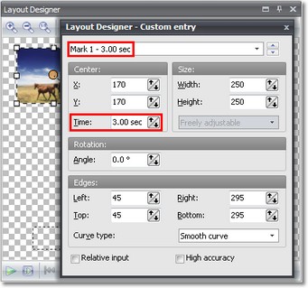

Now open Custom entry using the LABr_Menu icon.
Select the 2nd mark and change the setting under Size to Freely adjustable.
LA_ManualInput4_i
Then close Custom entry. It is possible to also carry out the next step from this menu, however we are choosing the Layout Designer directly.

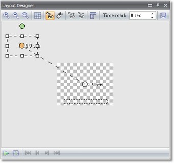

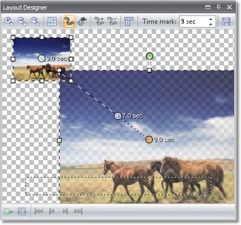

Using the positioning framework, reduce the image at the first mark, i.e. the mark which is outside the visible area. Then move the mark closer to the visible area.
LA_Image_moved4
Now play back the show and you will see that the image is larger when it is in motion.

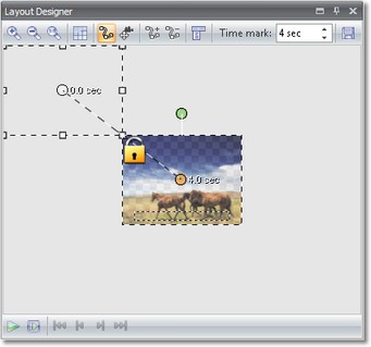

First of all, position the first mark in the visible area. Then restore the Layout Designer to Normal view using LABr_ZoomToOrigin.
Then access Custom entry.
LA_Image_moved5_i
First of all set the values shown in the image. In the Object settings of the image select a Transition. Afterwards play back the effect.

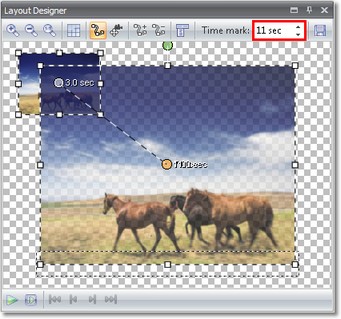

Then increase the time at the 3rd mark, as given in the image above. Then insert a 4th mark with LABr_AddMovementMark . You will not recognize this immediately, since it is inserted exactly over the top of the 2nd and 3rd marks.
Retrieve Custom entry using LABr_Menu .
LA_ManualInput6_i
Now, under Center and Size set the values which have already been used at the first mark.
If you now play back the show, you will see that the image is enlarged and then reverts to its original place.

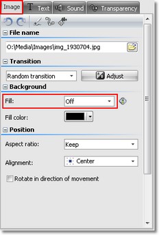

Now insert a new image into the show. Click on our image above once more and access the context menu using LABr_Menu . There select Copy path. Now mark the newly inserted image and access the context menu again using LABr_Menu and this time select Insert path.
In the Object settings of the 2nd image you have to disable the Fill background function.
Props_Image_Image_NoFill_i
