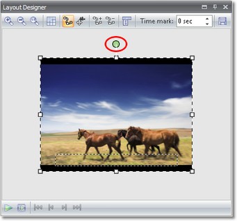

Select the image in Image list or Timeline to display it in Layout Designer. The use the LABr_ZoomOut button in Layout Designer to zoom out a little.
LA_Image_Rotation1_i

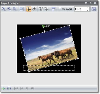

Now you can use the green handle to rotate the image. Click it, hold the mouse button down and define the rotation angle. Use the Position frame around the image to decrease its size.
LA_Image_Rotation2

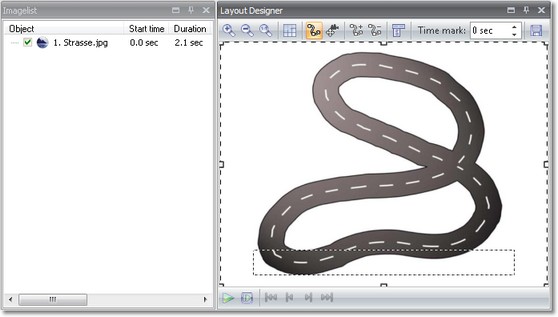

In our example we let the car follow a road. First we add the image of the road using the TBr_Plus button. Instead you can add your image of the map.
LA_Image_Rotation_CarRace1

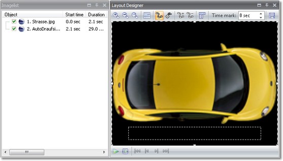

Now we need the car. Preferably it should be a PNG graphic with alpha channel.
Hint
Please consult the FAQ about how to create this type of graphic.
Add the car.
LA_Image_Rotation_CarRace2
Decrease the size of the image using the Position frame.
LA_Image_Rotation_CarRace3

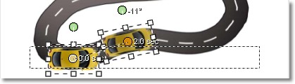

Now you can start the tour. Add a movement mark LABr_AddMovementMark and rotate the car a little, following the direction of the road.
LA_Image_Rotation_CarRace4

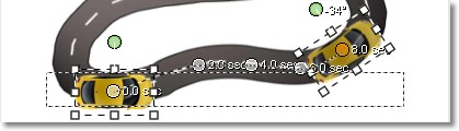

Add more movement marks and rotate the car accordingly.
LA_Image_Rotation_CarRace5
You can adjust the time marks for each movement mark individually. Click on a mark, it will then be highlighted. Change the time mark in the menu bar above the image.

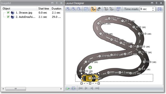

Eventually the complete movement path should look similar to the following graphic.
LA_Image_Rotation_CarRace6
Hint
The rotation angle can be larger than 360 degrees. This way you can simulate effects like the skidding of a car out of a curve.
