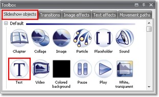

In the Toolbox there is the text object for this purpose.
TBx_SlideShowObjects_Text_i

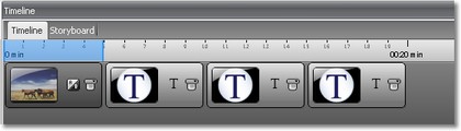

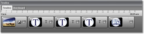

Insert an image. Using the Toolbox, now add 3 Text objects. You can do this with a double-click or by means of drag-and-drop (dragging with the mouse) into the Image list or onto the Timeline.
ImgL_multipleText
Timeline_multipleText

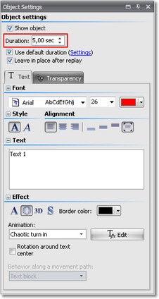

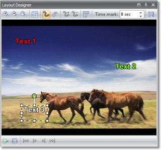

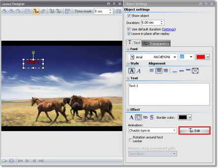

In the Object settings of the Text object, you can now enter your desired text and carry out the formatting. Position the text in the Layout Designer.
LA_Props_Image_multipleText_i

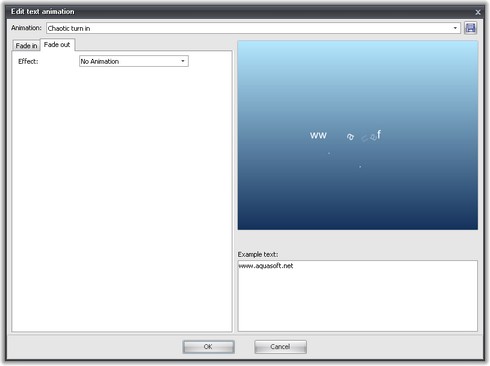

Select an animation and then call the editing function of the text effect via Edit.
So that the text is not faded out again before the next text is shown, the No fade out option must be set under Fade out.
Dlg_TextAnimation3
You can also have the text faded out if it is no longer supposed to be visible when the subsequent text is displayed.
Now repeat the steps with the second and third Text object.
LA_Image_multipleText

In the Object settings of the Text objects you can change the holding time of the texts.
Props_Text_Text_Full_i

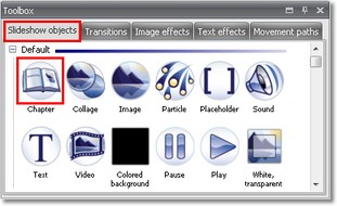

In order to now not show the texts in sequence, but simultaneously, the Chapter object is required. Use the little show that you have just created.
TBx_SlideShowObjects_Chapter_i

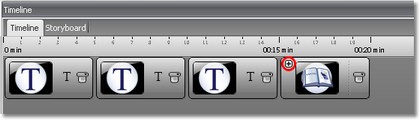

Add the Chapter object into your show.
ImgL_multipleText_withChapter
Timeline_multipleText_withChapter1
The Chapter can have several tracks and therefore show the Slideshow objects in parallel/simultaneously.

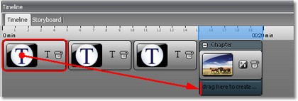

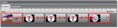

Click on the image on the Timeline and drag it with the mouse button pressed down to the Chapter object. The Chapter is framed in red if you go over it with the mouse. If this red frame appears, "drop" the image.
Timeline_multipleText_withChapter2_i
After that it looks like this on the Timeline. You now have to open the Chapter. There is a little plus symbol for that.
Timeline_multipleText_withChapter3_i

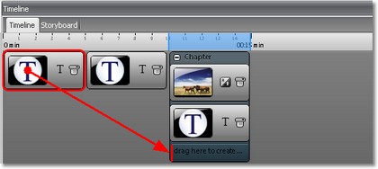

Now drag the first Text object into the Chapter. Drag it to underneath the image in the Chapter. A red vertical bar will appear if you move the mouse to the correct position.
Timeline_multipleText_withChapter4_i

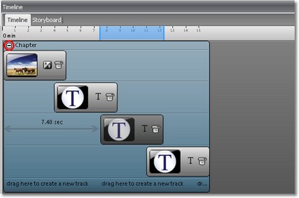

Using the Timeline you can adapt the timing individually. For this, you can simply drag the Text objects with the mouse into the starting position.
Timeline_multipleText_withChapter6_i
