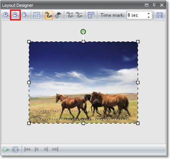

With camera pans the images must be enlarged beyond the visible area. For that purpose, reduce the display of the visible area with the LABr_ZoomOut icon.
LA_Image_zoomedout_i

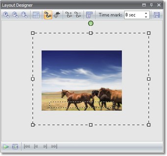

Now enlarge the image using the positioning frame until it looks similar to the image below.
LA_Image_CameraPan1

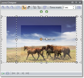

Then, with the LABr_AddMovementMark, insert a new movement mark and position it to the left of the first movement mark.
LA_Image_CameraPan2
Increase the time at the second movement marker, so that the movement is carried out more slowly. Should you not wish to have any Transition at the beginning of the movement path, you can set None in the Object settings of the image.

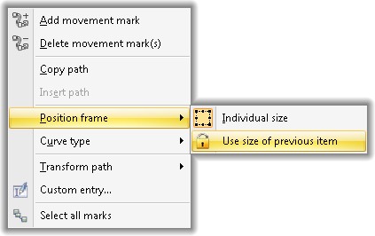

Then, with the right mouse button, retrieve the context menu at the 2nd movement mark marked. Now, in the latter, select Position frame/Use size of previous item. As a result, the size of the second movement mark is automatically adapted to the size of the previous one and can no longer be changed accidentally.
Menu_PositionFrame
Info
Every image with the setting Use size of previous item is marked in the Layout Designer with a schloss .
