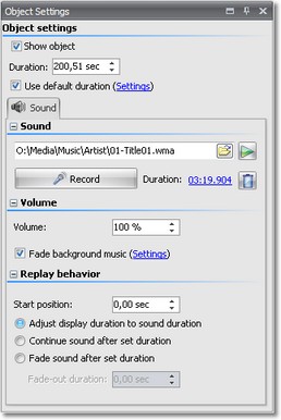

With a Sound object the following settings are possible:
Props_Sound
Props_SoundSongCombo
With the folder icon you can insert or remove a music file. The track selected is shown on the left next to the icon.
Btn_PlaySound
Plays back the music file
Btn_RecordSound
Opens the Sound Wizard. With this you can record a commentary for the image via a microphone connected to the PC. You can find more on the Sound Wizard here.
Volume
Displays the volume at which the sound is supposed to be played back.
Fade out background music
If this option is enabled, the background music is faded (volume decreased) when the music file is played back.
Play back the full length of the sound
If this check mark is selected, it means that it plays back the full length of the Sound object.
Continue to play the sound after the duration set
With this option the sound can receive a shorter exposure time. The sound is then simply played on into the next images until it has come to an end.
Fade out the sound after the duration set
Should you wish to only play back the sound for a certain period of time and then end it, you have to select this option. Under Duration you can set the fading out time.
