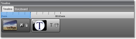

Insert an Image and a Text object into your show.
ImgL_Image_Text
Timeline_Image_Text

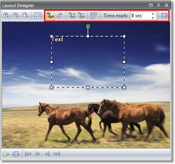

Then click the Text in the Image list or on the Timeline. In the Layout Designer the tools for the movement path are now enabled.
LA_Image_Text_i
LABr_MovementPath
This is the icon for switching, in the Layout Designer, into the mode for movement paths. There is yet another mode for camera pans and zoom. Since this function is not available with the Text object, the icon for the movement path mode is active.

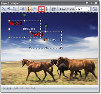

Insert a movement mark by clicking LABr_AddMovementMark.

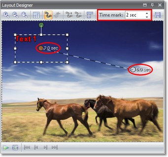

Chronological sequence
LA_Image_movedText2_i

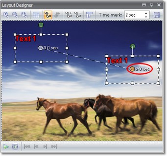

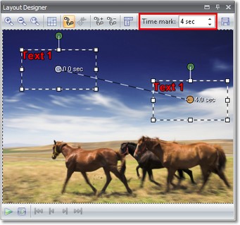

With Time mark you can control the sequence. If you increase the time, the sequence becomes slower. If you reduce the time, the sequence becomes faster.
First increase the Time mark of the movement point and then replay the show.
Starting time
LA_Image_movedText3_i
If the movement sequence is only supposed to begin after a time delay, you can increase the Time mark with the first movement mark. For that purpose, click the movement mark and then increase the time unit. The subsequent movement marks will automatically be adapted.

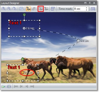

Inserting additional movement marks
You can insert as many Movement marks as you like. The new movement mark is always inserted after the previously selected mark.
LA_Image_movedText4_i
Select the last movement mark and with LABr_AddMovementMark insert a new mark and position it in the Layout Designer.
Play back the show. You will find that the last part of the movement path elapses faster than the first part. You can control this for the 3rd movement mark via the Time mark.

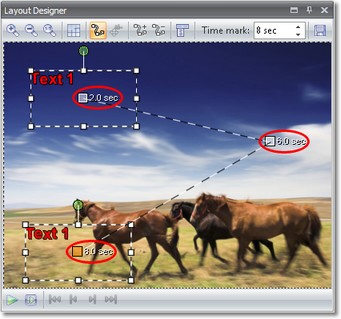

Hard and soft curves

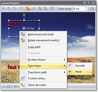

In the course of movement you can choose between hard and soft curves. With Hard curves the path will run exactly in accordance with the movement marks. With Soft curves a round course of movement will take place. You can use both curve types within one path.
LA_Image_movedText_Menu
Select a movement mark. Using the right mouse button you will get the menu for this movement mark and can change the Curve type there.
Change the Curve type for all 3 marks.
LA_Image_movedText4_hard_i
You will see that the movement marks now have a rectangular marking point. Selecting Soft curves these points become round.
In order to see the change in the path, play back the show.

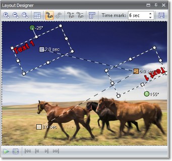

Rotating text during movement sequence

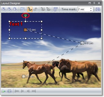

In SlideShow Ultimate you can rotate or swing texts during a movements sequence also.
For this purpose there is a green handle above the Text field. More extensive information about the rotation functionality for Text you can find here.
LA_Image_movedText4_rotate_i

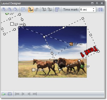

First rotate the text at the first and second movement marks. Rotations through 360 degrees are also possible, to create complete rotation.
LA_Image_movedText4_rotated

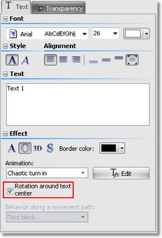

Play back the show. You will see that the rotation center is, in this respect, the midpoint of the text box. Should the rotation center be the center of the text, enable the Rotation around text center function in the Text properties.

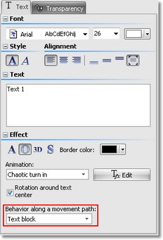

There is another option for text moving along a path.
Props_Text_Textbehavior_i
Use it to let text "snuggle up" to the path as text block or even character by character. The text will rotate according to the path direction.

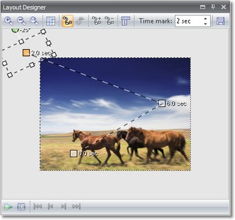

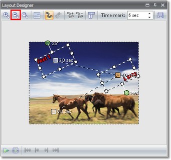

Continue to use the show you just created. Reduce the visible area with LABr_ZoomOut in order to see the invisible area in the Layout Designer.
LA_Image_movedText4_rotated_zoomout_i
Now select the first movement mark and drag it into the invisible area.
LA_Image_movedText4_rotated_movedout
Play back the show. The Text will now fly into the picture from the outside.

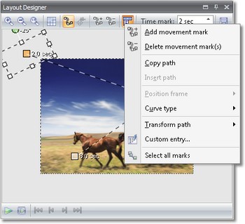

Via LABr_Menu the context menu for the movement marks can be opened. With a right-click on a selected movement mark, this menu can likewise be opened.
LA_Image_movedText4_rotated_menu
Some options have already been used above. The following further options are available:
MenuItem_copyPath
A movement path already created can be copied and thus re-used with a slideshow object. If you copy a movement path from a text object, this can also be inserted in the case of an image.
MenuItem_insertPath
With this option, you re-insert a copied path from the clipboard.
MenuItem_PositionFrame
If you want to be sure that the text or the image does not change size in the course of your movement path, you can set the Use the size from the previous one option here.
MenuItem_CurveType
There are hard and soft curves with a movement path. The course of a movement can thereby be modified.
MenuItem_transformPath
A movement path can also be mirrored or rotated. You will find the available options under this point.
MenuItem_manualInput
MenuItem_selectAllPoints
With this all movement marks can be selected. Thereafter it is possible to drag the movement path as a whole.
