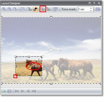

Now click the LABr_AddMovementMark icon. This inserts a movement mark. A position frame is now drawn around this additional mark. Reduce the size of this mark by means of the position frame and drag the section to the place which is supposed to be enlarged.
LA_Image_Zoom1_i
So that the Transition does not have a disturbing effect on the Zoom, you can set the Transition in the Object settings of the image to None or increase the Timestamps.

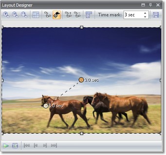

The 2nd mark is still marked (orange). First of all set the time there at 4 seconds. Then click the first mark in the Layout Designer and set the value to 3 seconds or more.
LA_Image_Zoom2
You can see that, by changing the time of the first mark, the subsequent marks also change automatically. In this way the movement set remains unchanged within the path.

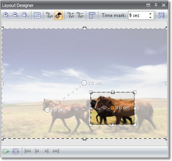

If you would like to zoom in on several sections of an image, you can now use a movement path in the image. Imagine you have a group photo and now wish to zoom in on the individual persons. However, you do not wish to constantly zoom in and out, but go over the faces in the image.

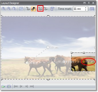

For that purpose, you can now insert an additional movement mark with the LABr_AddMovementMark icon. Position the mark at the desired final point.
LA_Image_Zoom3
If you now play back the effect, you will now see that a camera pan is possible within the image. Using the time of the last movement mark you can control the speed. If you increase the time, the shot becomes slower.

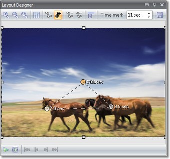

In order to revert back to the full size, insert a new movement mark. Please ensure that the last movement mark is selected.
LA_Image_Zoom4_i
The easiest thing to do is now to use the Custom entry. Retrieve this with a right mouse-click button or by using the LABr_Menu icon.
LA_ManualInput12_i
At Mark 4 set 500/500 as the Center and 1000/1000 under Size . As a result, the image at Mark 4 is displayed in its entirety, again.
LA_Image_Zoom5
Now simply click TBr_Play and enjoy the effect.

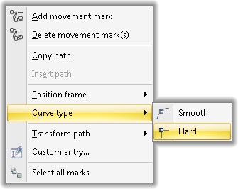

The movement path can be changed using the Curve type. Select Select all marks by means of the LABr_Menu icon and click in the Layout Designer with the right mouse button.
In the context menu which now appears, select Curve type -> Hard.
Menu_CurveType_hard
You will now see the change in the form of the movement mark. This is now square, in order to represent the chosen Curve type.
After clicking TBr_Play you can see the change in the zoom. The pan in the curves is now Hard and is no longer carried out soft.
