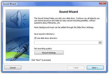

Using the “Sound Wizard” you can record spoken commentaries and noises with your images using a microphone connected to the PC. You will find the “Sound Wizard” in the menu under “Wizards”.
You can save the resulting files in the slide show directory or in a separate directory. Under “Record-Settings” you can decide the settings with which the commentaries should be recorded. Then click “Next”.

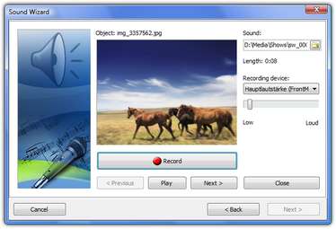

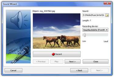

Now all the images in the show with which you can include a commentary will be shown to you in sequence. To do so, simply click “Record” and then speak your commentary on the relevant image. Should you make a mistake while recording, you only need to re-record the commentary for the selected image.

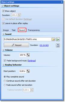

With “Play back” you can hear your recording. In order to get to the next image, click “Next”. Once you have finished recording, close the “Sound Wizard”. The “Sound Wizard” automatically matches up your images with the commentaries recorded. You can find the recorded file in the “Object settings” of the relevant image. The recording can also be played back here, using the
The “Sound Wizard” can also be started directly from the “Object settings” of an image. For that there is the “Record” button.
