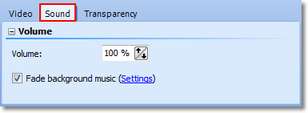

Sound
Here you can determine if the background music should be faded out when the video is played back. If the video does not have its own sound, but perhaps a noise has been recorded, set the volume of the video to 0% and remove the check mark beside “Fade background music”.
