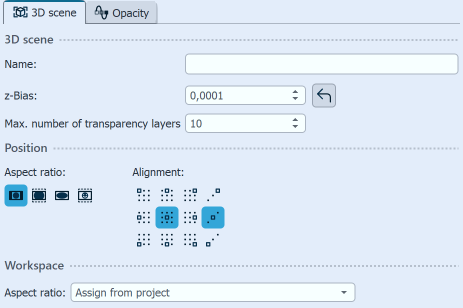

2 Settings of the 3D scene object
Properties 3D scene
Properties of the 3D scene
Select the 3D scene object in the Timeline to see its properties.
The z-Bias controls how much influence the track number has when the z-values of objects in the scene are compared with each other. The set value is multiplied by the track number and added internally to the actual z-value, so that objects in the same positions are still different and distinguishable.
The Max. Number of transparency layers is used to set the number of consecutive layers with transparency that the 3D scene can detect from the viewer's perspective. If there are fewer than set, the 3D scene stops searching at the last layer. If there are more than one setting, you can no longer see the layers beyond this. However, as a large number of layers can have an impact on performance and lead to stuttering during playback, it may be advisable to temporarily reduce the value.
The workspace for the 3D scene is determined by the project aspect ratio X:Y:Z. The value for Z is derived from the shorter side of the aspect ratio. However, the 3D scene can also have its own aspect ratio. To do this, select the setting Own for Aspect ratio. With the setting Automatic, the aspect ratio of the parent element (of another 3D scene or a Flexi collage) is adopted.

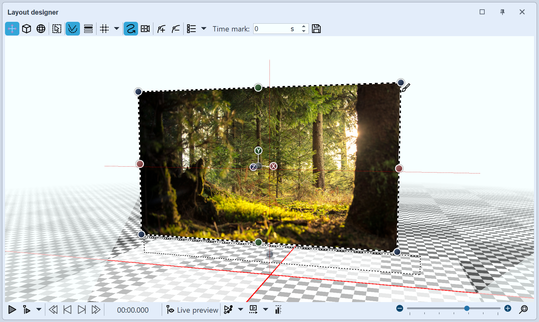

In the Layout designer, as soon as you view an object within the 3D scene, the workspace is visualized by a bright area on the bottom.

In the Timeline, select the object that you want to view or edit within the 3D scene. The Layout designer switches to the 3D view. The color of the surrounding 3D space is light or dark - depending on the selected theme.
Click the mouse in the checkered area of the Layout designer. Use the mouse wheel to zoom in and out of the scene. To change the viewing angle on the object, drag horizontally or vertically across the checkered area while holding down the mouse button.
To restore the normal view, click the magnifying glass at the bottom right of the Layout designer.
Format-filling image in 3D scene
The position of the image in 3D space results from the X, Y and Z coordinates. For this purpose, rotation on the X, Y and Z axes (as well as combinations) is possible .
In the 3D space, the position X=50 / Y=50 / Z=50 is displayed with red marking lines.
To change the values for position, rotation or object size directly by numerical input, open the Manual input.
You can also change the size, position and rotation of the object directly in the Layout designer. The following icons are available at the top left of the Layout designer for this purpose:

Select the mode and then click on the object whose 3D properties are to be changed. Use the X/Y/Z handles to implement the respective change or move the object directly with the mouse.
For resizing, you can also use the colored handles on the dashed selection frame of the object.
