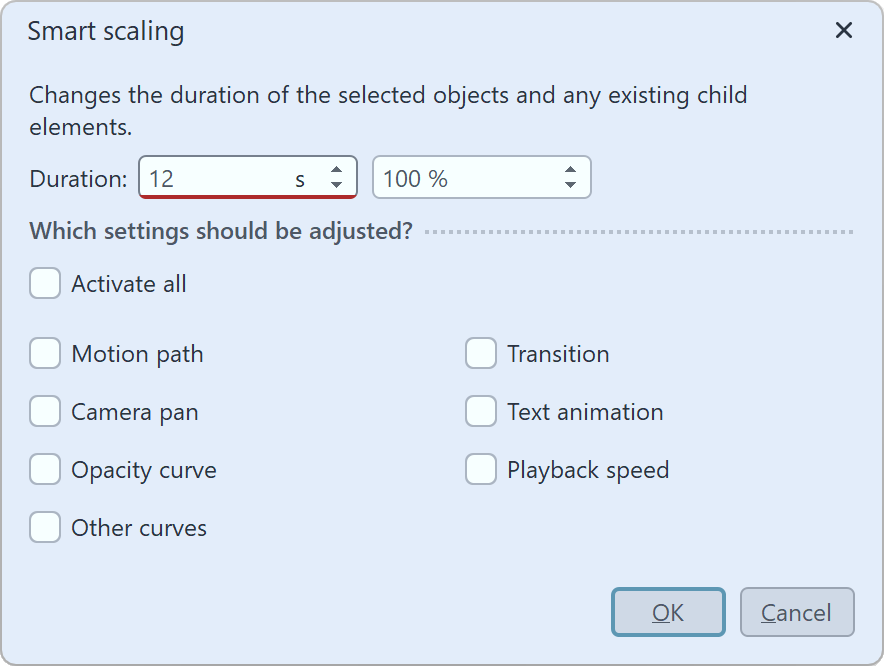

Smart scaling
Smart scaling
Adjust duration intelligently
Use this function to change the display duration of objects and adjust transitions, motion paths, transparencies, camera pans and text animations.
The playback speed of sounds and videos can also be adjusted to a new duration, allowing videos and sound to be played faster or slower.
First select the object to be adjusted in the Timeline. This can also be a chapter object or a Flexi-Collage.
Then click on the Smart scaling icon. Enter the new target duration and specify which property of the selected object should also be adjusted.
There are constellations where it is difficult to recognize how large the value for the new total duration of the content to be scaled must be, for example the area between two marking lines. To help, insert a placeholder object and drag it to the required duration in Timeline. Then read the properties of the placeholder to find out what the new target duration must be. Then remove the placeholder object again.

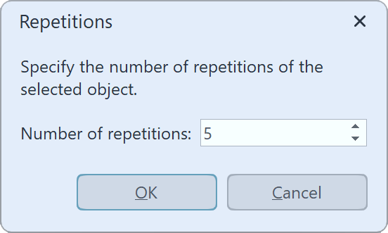

Multiply objects
Multiply objects
Multiply objects
If you want to copy and paste several objects with identical properties repeatedly, a corresponding function is available. Inthis way, even more complex Chapters and Flexi-Collages can be quickly multiplied and pasted one after the other.
To do this, select the object to be multiplied and go to Edit / Multiply and specify the number of repetitions you want.
