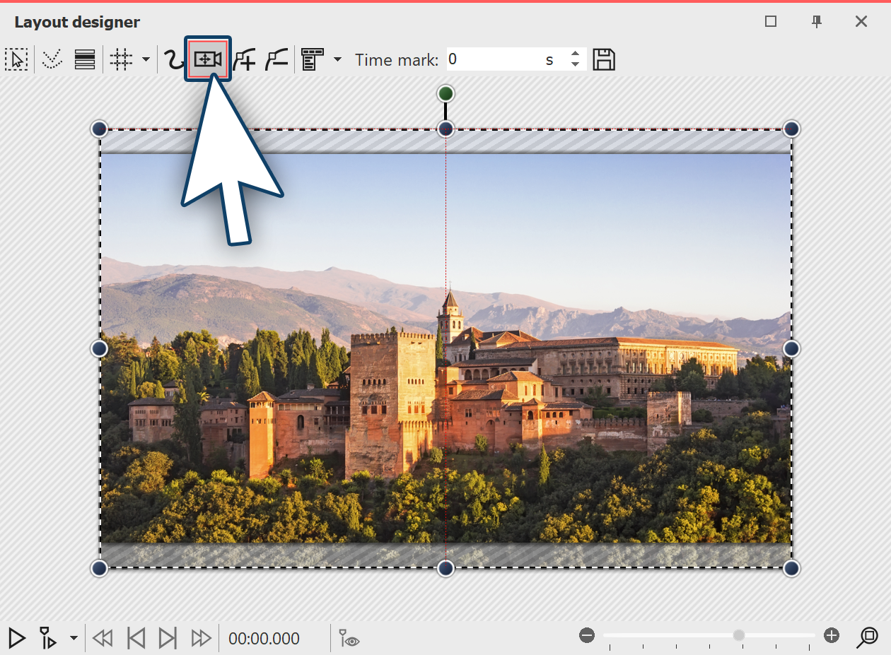

1. Inserting the image and activating the tracking shot
Panoramic image in the layout designer
First of all, add an image which you would like to pan across. It need not necessarily be a panoramic image. The panoramic motion can also be used for normal images.
It is particularly well suited to recordings where you have images over which one’s “gaze can wander”, like, for example, landscape shots or photos of landmarks.
In order to activate the zoom & camera panning tool, click on the icon in the Layout designer.

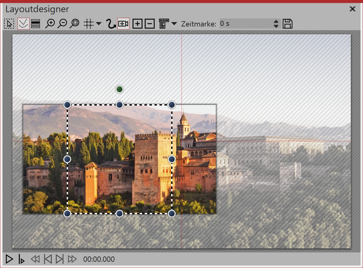

2. Selecting motion markers
An image detail that does not match the aspect ration of Diashow.
As soon as the zoom & camera panning tool is enabled, the image will be surrounded by a dotted frame. At the edges and corners you will find drag points which you can use to rescale the image.
Use your mouse to click on the drag point and hold the mouse buttong down.
Now drag the frame so that, as in the pictured example, you make it smaller. If parts of the image can be seen beyond the frame and they are not hatched, the aspect ratio of the section does not match the aspect ratio of the show.
This has the consequence that the projecting regions are shown in black or that the underlying object can be seen.

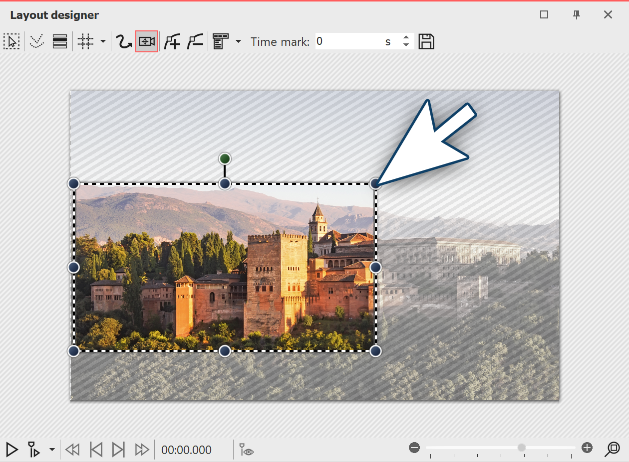

3. Fitting a frame to an aspect ratio
The detail fits the aspect ratio
To avoid black bars later on in the project and to achieve a good-looking result, drag the border so that the parts of the image which go beyond the dotted line are no longer displayed.
Now position the dotted line at the point the panorama is to begin.
In the example, the panorama goes from left to right. The first motion marker must also be positioned on the left.
