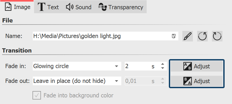

Adjust Fade in or Fade out
You can change the duration of a transition directly in the Object settings.
If you want to customize the appearance of a transition to your liking, click the Adjust button in the Object settings section.
 VIDEO VISION   STAGES  Depending on the transition type, completely different and additional setting options are available.

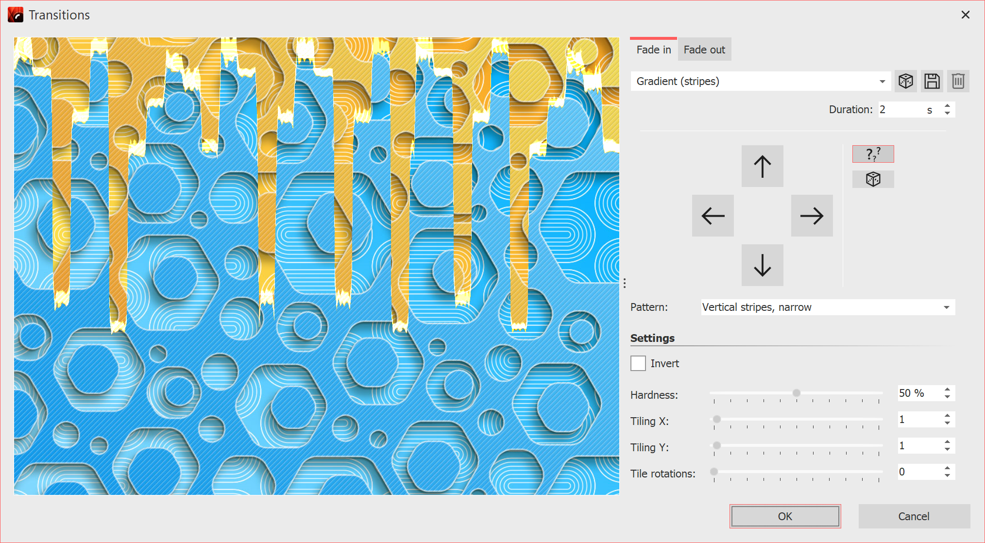

Adjust the fade-in or fade-out parameters to your liking.
Customizing a transition
Customizing a transition (Video Vision)
Use the drop-down menu to choose from the available transitions. Use the dice icon to display a random transition and modify it or roll the dice further if necessary.
 VIDEO VISION   STAGES  You can save self-created or customized transitions using the disk icon. Formore on saving custom fade-ins and fade-outs, see the Saving transitions section.
Btn_Customize_Random
Random parameters for this transition at each playback
Btn_Customize_RandomSet
Set random parameters for this transition

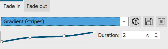

Control transition with curve  STAGES
Curve for transitions (Stages)
In Stages, the transition can also be controlled via curve. Click the mouse in the field with the slanted line to change the transition timing.
