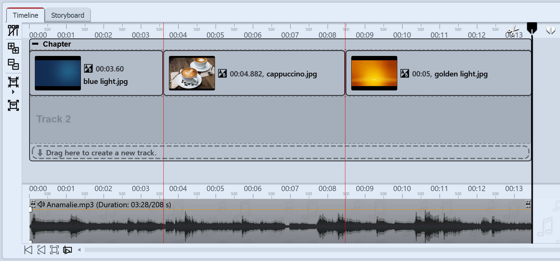

Hold down  Shift  and click on the scale in the Timeline (see picture below). A red line will appear that you can move while holding down the mouse button. The line goes across your inserted objects and the Background music track, so you can use the music's envelope as a guide when placing the line, for example.
If you want to delete a line, then a click with the right mouse button on this line is sufficient.
Images aligned to lines
Images aligned to marker lines
