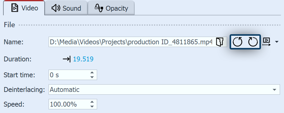

Drag a Video object from the Toolbox to the Timeline and select your video file. Or drag the video directly from the File browser to the Timeline.
The Layout designer now displays the video. If rotation is required, click the appropriate icons (to the right of the file name) in Properties to rotate the video 90° left or right.
Repeat the rotation until your video appears correctly.

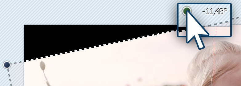

Then, using the minus magnifying glass icon, shrink the view in the Layout designer. Make sure that the motion path tool (curved arrow) is active.
Centrally located above the video you will find a handle to rotate the video. Hold down the mouse button to drag the handle in the direction you want to rotate the video. Next to the drag handle you have used for turning, a number will appear. This indicates the angle of the image’s rotation.

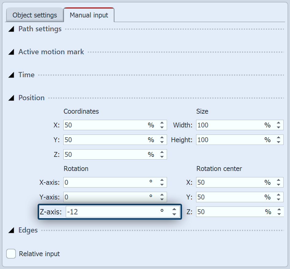

If you want to enter an exact value for the angle of rotation, right-click on the image in the layout designer. From the context menu that now appears, select the Manual input item  so that the corresponding window opens for this purpose.
Under Rotation you can now enter a value for the Angle yourself. Negative values are also possible here. If you want to rotate your video, which you have recorded in portrait format, into landscape format, enter 90° or -90° here, for example.
