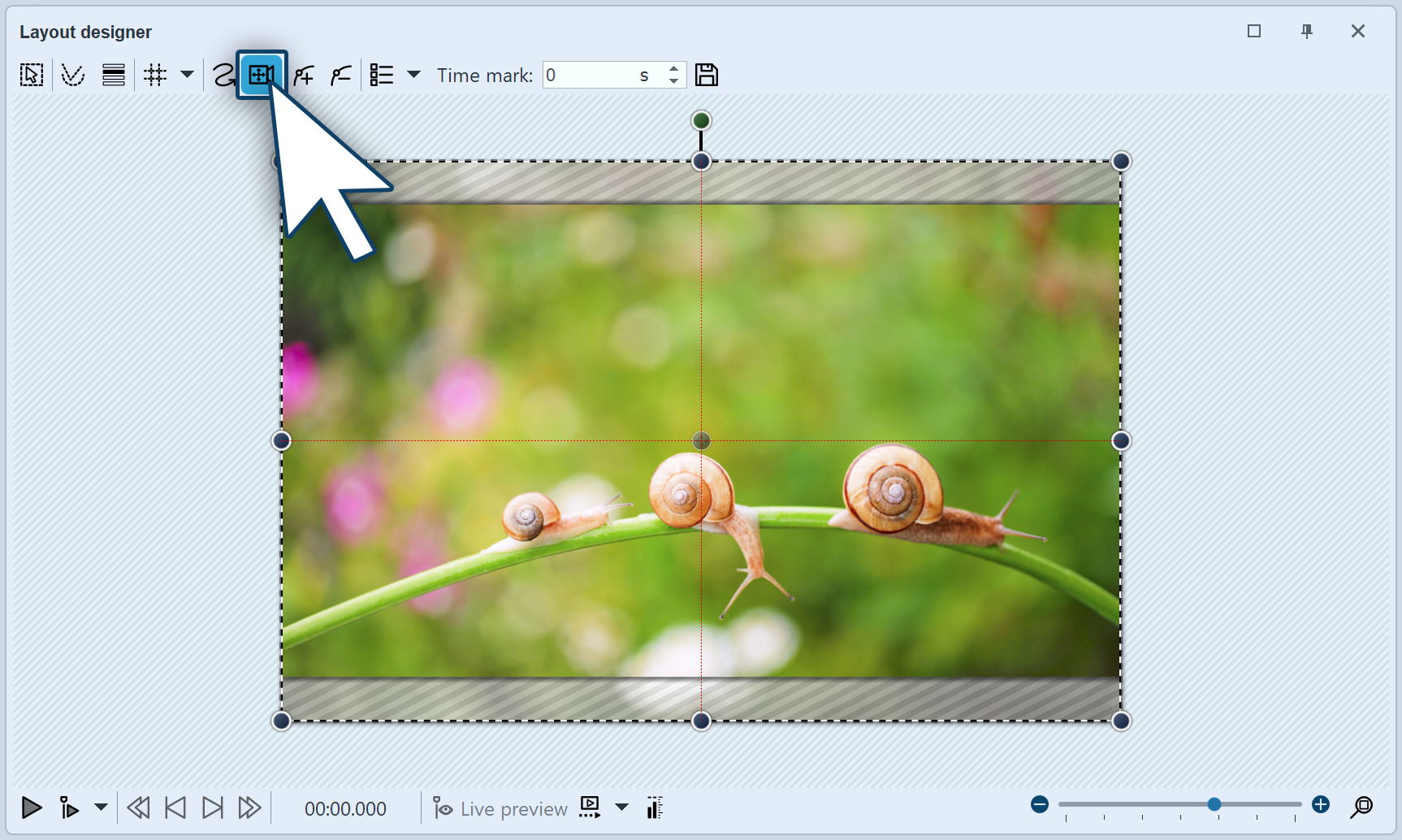

In the Timeline select the object you wish to zoom in on. Then, in the Layout designer switch into camera panning mode, by clicking on the camera pan icon in the top bar of the Layout designer.
