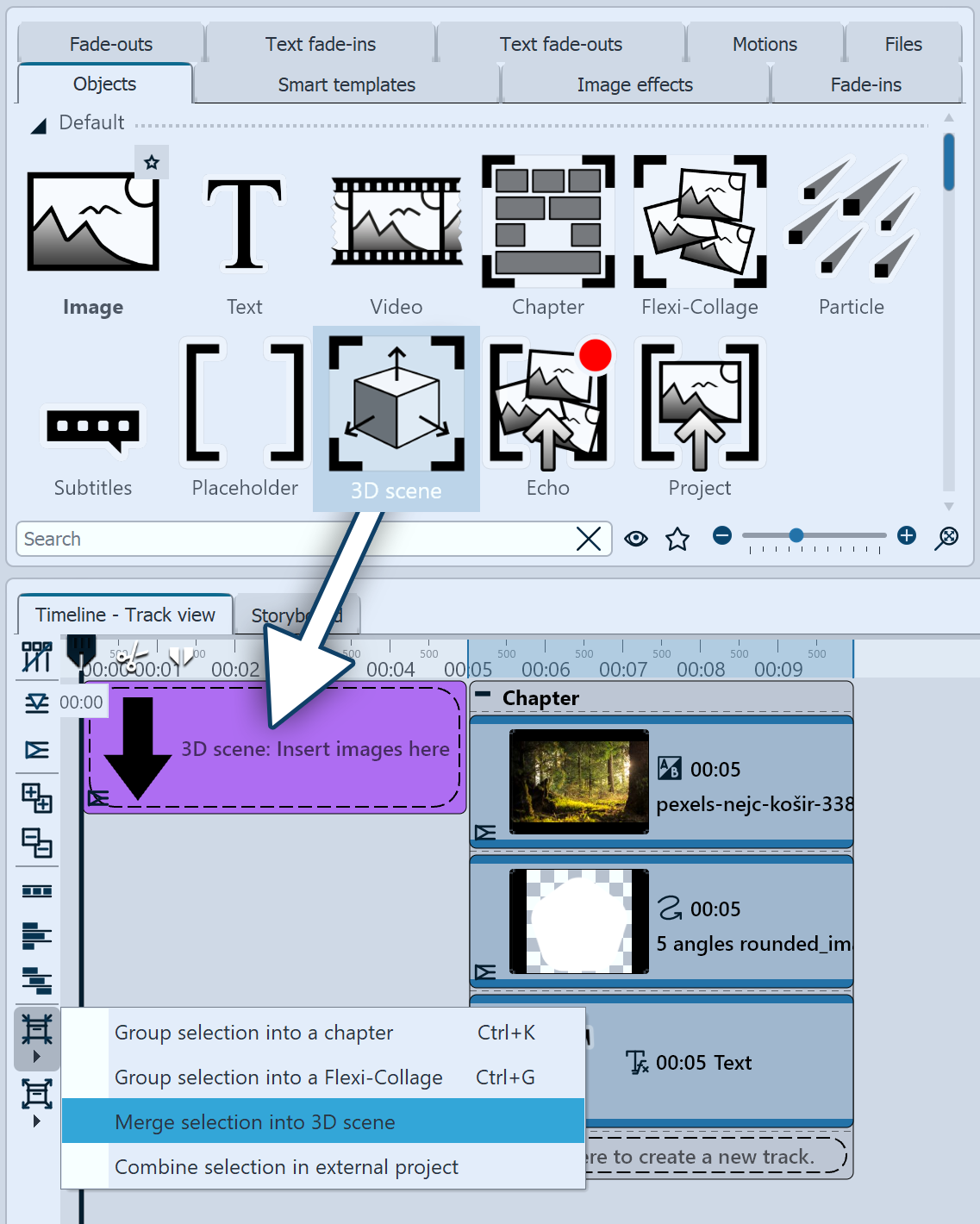

Drag the 3D scene object from the Toolbox to the Timeline. Fill the object with images, videos, or text objects.
You can also select one or more objects in the Timeline and use the Merge icon on the left edge of the Timeline to merge the selection into 3D scene.

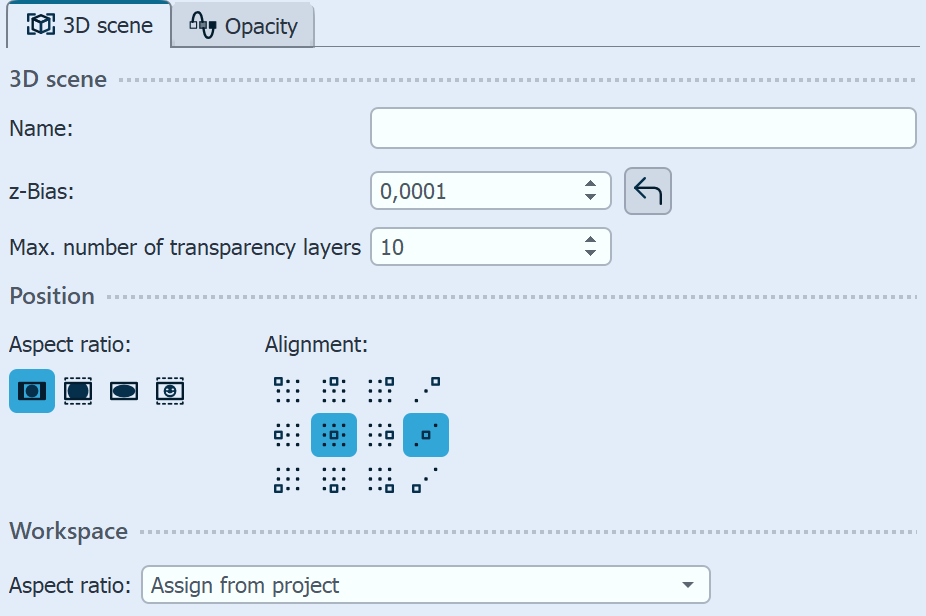

Select the 3D scene object in the Timeline to see its properties.
The z-Bias controls how much influence the track number has when the z-values of objects in the scene are compared with each other. The set value is multiplied by the track number and added internally to the actual z-value, so that objects in the same positions are still different and distinguishable.
The Max. Number of transparency layers is used to set the number of consecutive layers with transparency that the 3D scene can detect from the viewer's perspective. If there are fewer than set, the 3D scene stops searching at the last layer. If there are more than one setting, you can no longer see the layers beyond this. However, as a large number of layers can have an impact on performance and lead to stuttering during playback, it may be advisable to temporarily reduce the value.
The workspace for the 3D scene is determined by the project aspect ratio X:Y:Z. The value for Z is derived from the shorter side of the aspect ratio. However, the 3D scene can also have its own aspect ratio. To do this, select the setting Own for Aspect ratio. With the setting Automatic, the aspect ratio of the parent element (of another 3D scene or a Flexi collage) is adopted.

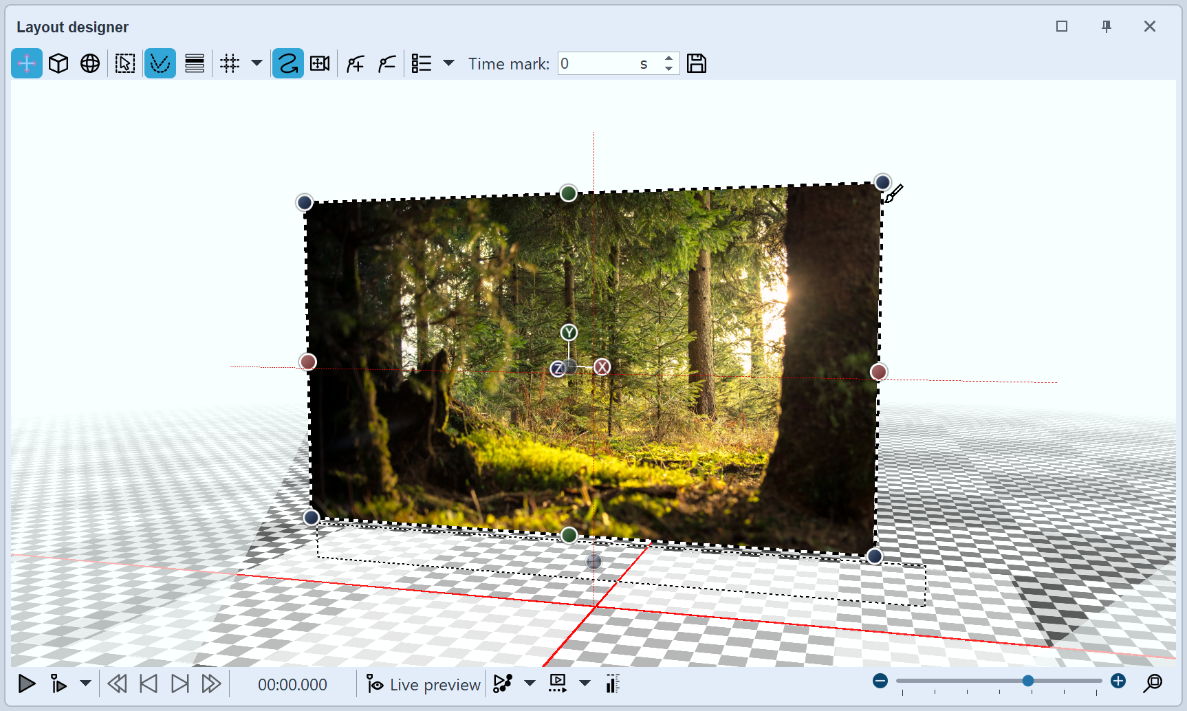

The position of the image in 3D space results from the X, Y and Z coordinates. For this purpose, rotation on the X, Y and Z axes (as well as combinations) is possible .
In the 3D space, the position X=50 / Y=50 / Z=50 is displayed with red marking lines.
To change the values for position, rotation or object size directly by numerical input, open the Manual input.
You can also change the size, position and rotation of the object directly in the Layout designer. The following icons are available at the top left of the Layout designer for this purpose:
Btn_LA_3Dmove
Moving the object and scaling
Btn_LA_3Dscale
Scaling the object (resizing only)
Btn_LA_3Drotate
Changing rotation and scale
Select the mode and then click on the object whose 3D properties are to be changed. Use the X/Y/Z handles to implement the respective change or move the object directly with the mouse.
For resizing, you can also use the colored handles on the dashed selection frame of the object.
