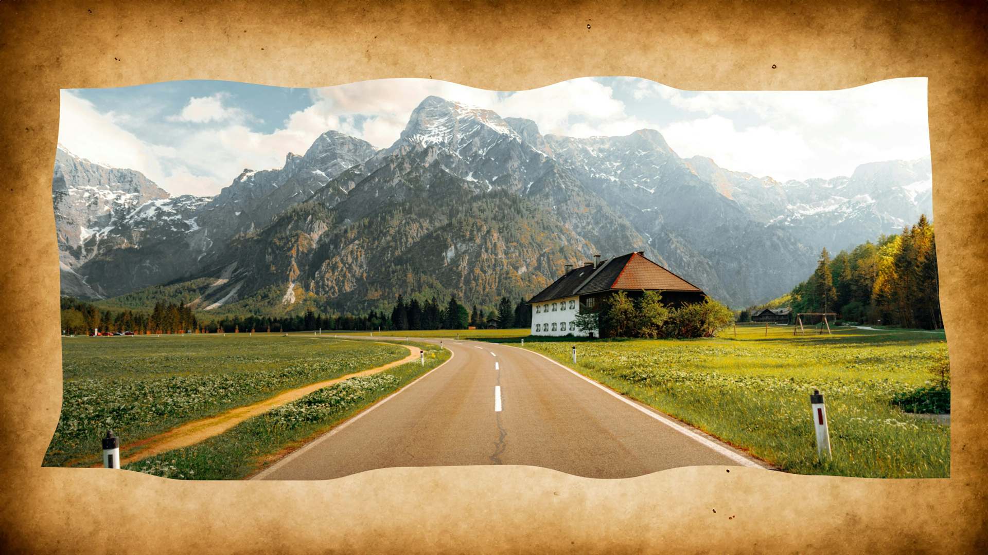

Example of a Torn-edge effect on a photo against a paper background

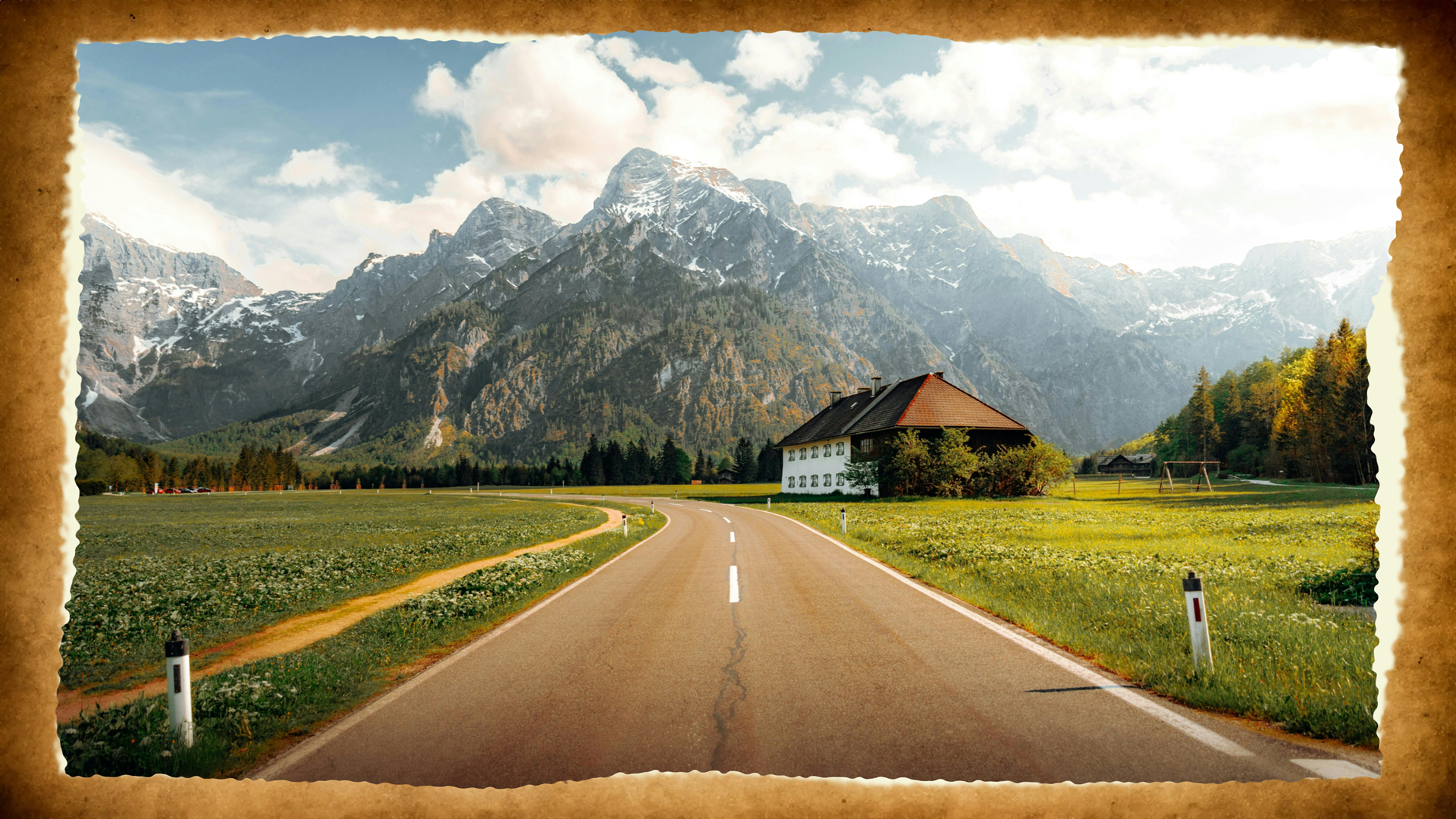

Torn-edge effect with different settings
Torn-edge effect with different settings (including transparent border color)
