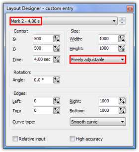

Now open “Custom entry” using the Select the 2nd marker and change the setting under “Size” to “Freely adjustable”.

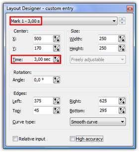

Now play back the show and you will see that the image is larger when it is in motion. You can select a “Transition”, or also "None", in the “Object settings” of the “image”. First of all, position the first marker in the visible area. Then restore the “Layout Designer” to “Normal view”. with Then access “Custom entry”.
First of all set the values shown in the image. In the “Object settings” of the image select a “Transition”. Afterwards play back the effect. Now the image should “fly” back to its original position. For this, two additional “movement markers” are required. Click the 2nd marker in the “Layout Designer” and then insert an additional movement marker with

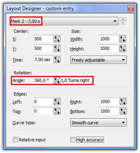

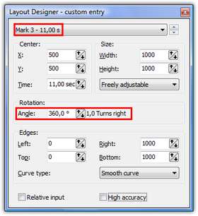

Then play back the show once in its entirety. And how do you like the effect? In SlideShow Studio you can use “Rotations“. This is easy to accomplish via “Custom entry”, too. Open the context menu for an image via
Play back the show. These “movement paths“ can be used on the following “Slideshow objects“:
