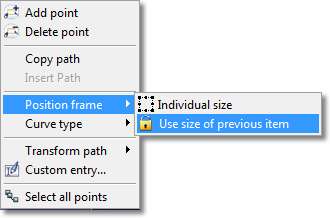

Increase the time at the second movement marker, so that the movement is carried out more slowly. Should you not wish to have any “Transition” at the beginning of the movement path, you can set “None” in the “Object settings” of the image. Then, with the right mouse button, retrieve the context menu at the 2nd movement marker marked. Now, in the latter, select “Position frame”/“Use size of previous item”. As a result, the size of the second movement marker is automatically adapted to the size of the previous one and can no longer be changed accidentally.
