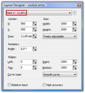

If you now play back the effect, you will now see that a camera pan is possible within the image. Using the time of the last movement marker you can control the speed. If you increase the time, the shot becomes slower. Zooming out You can have the image cross faded while you are zoomed in on the section, or first revert back to the overall image size. In order to revert back to the full size, insert a new movement marker. Please ensure that the last movement marker is selected.
The easiest thing to do is now to use the “custom entry”. Retrieve this via the right mouse button or via the
At “Marker 4” set 500/500 as the “Center” and 1000/1000 under "Size” . As a result, the image at Marker 4 is displayed completely, again.
Now simply click
As you can see, it is very easy to zoom images. Simply insert movement markers and position them as desired – and already motions enters your image. The movement path can be changed using the “Curve type”. Select “Select all markers” by means of the In the context menu which now appears, select “Curve type”/“Hard”.
