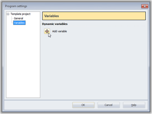

2.Click on "Variables" on the left side of the dialog.
Now add variables to the template by clicking the Add Variable button.
Variableneinstellungen

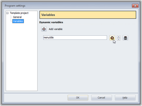

3.Then type a name for the variable:
Variableneinstellungen 1

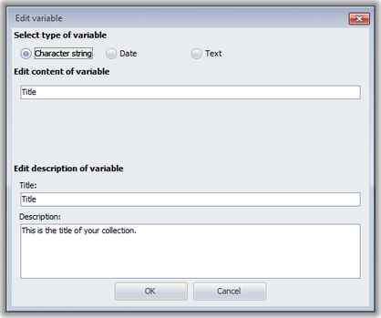

4.Click the Edit Variable button to adjust other settings for the new variable.
In the dialog you specify of which type your new variable is.
Variableneinstellungen 2
The following types are available:
String
This is a single-line text. Use this type for short text like titles, captions, etc.
Date
This can be any date.
Text
This is a multi-line text for any purpose.
Specify the name for the variable that shall later be displayed in SlideShow-Manager's customization menu. If you don't specify anything the name that you chose when creating the variable will be displayed.
Additionally, you can type a description for the variable that will be displayed in the customization menu, as well.
