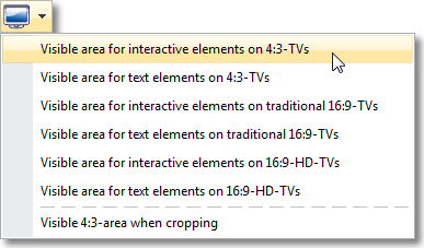

5.TVs, and traditional CRT-TVs in particular, have an area at the edges of the monitor called overscan in which a correct display cannot be guaranteed. The film technology distinguishes between the following areas:
action safe: this area guarantees that all actions stay visible
title safe: this area guarantees the visibility of text and caption overlay
You can show or hide these areas using the TBr_Screen menu.
Safe Areas
6.Additionally you can show the area which encloses that part of the template that would remain if it were cropped to 4:3 format.

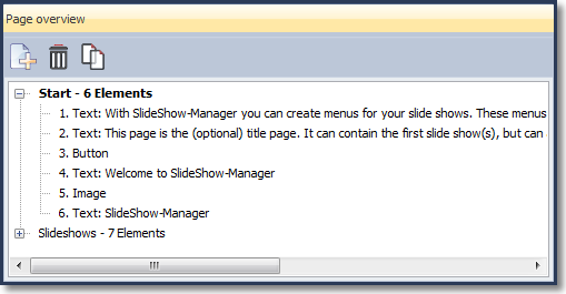

8.Please take good care that buttons and slide show objects are placed on top of all other non-interactive elements and that they are not covered by any other element. This way you avoid problems navigating in PC menus.
You can place an element on top of all other elements by moving it with the mouse underneath the last element of a the edited page in page structure view.
