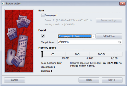

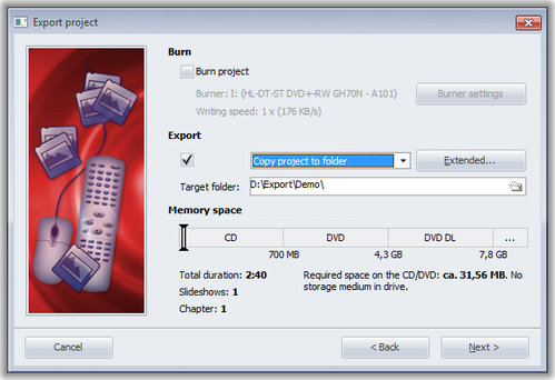

6.Deactivate the check box "Burn project" and activate the check box left of the drop-down list.
Select the entry "Copy project to folder" from the drop-down list.
Activate the check box "with Player" if you want to export the player for your menu in addition to your project.
Activate the check box "with fonts" if you also want to copy the fonts that your templates are using.
Select a target folder for the export and click "Next".
