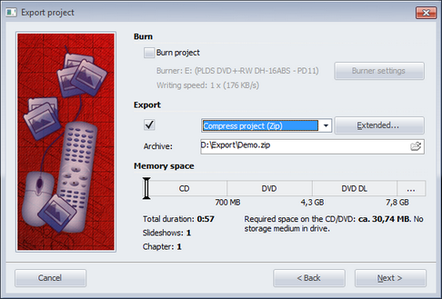

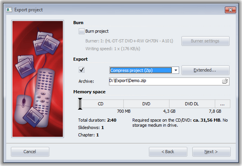

6.Deactivate the check box "Burn project" and activate the check box left of the drop-down list.
Select the entry "Compress project (Zip)" from the drop-down list.
Activate the check box "with Player" if you want to copy the player for your menu in addition to your project to the ZIP file.
Activate the check box "with fonts" if you also want to copy the fonts that your templates are using to the ZIP file.
Specify a target file and click "Next".
