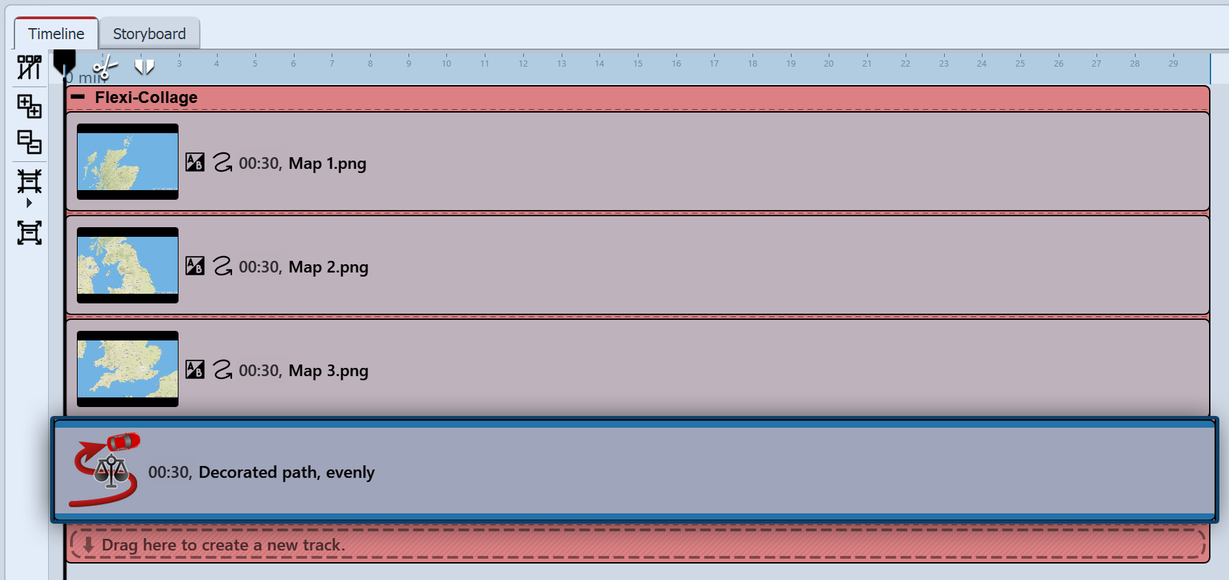

1 Insert a Flexi-Collage
Flexi-collage
Inserting a flexi-collage
Several maps should be inserted, which are combined together to form a collage.
So that the map sections can later be treated as one whole object, they are grouped together in a Flexi-Collage.
In the first instance, drag the Flexi-Collage from the Toolbox into the Timeline.
1. Select the first map section
Dragging a map into a flexi-collage

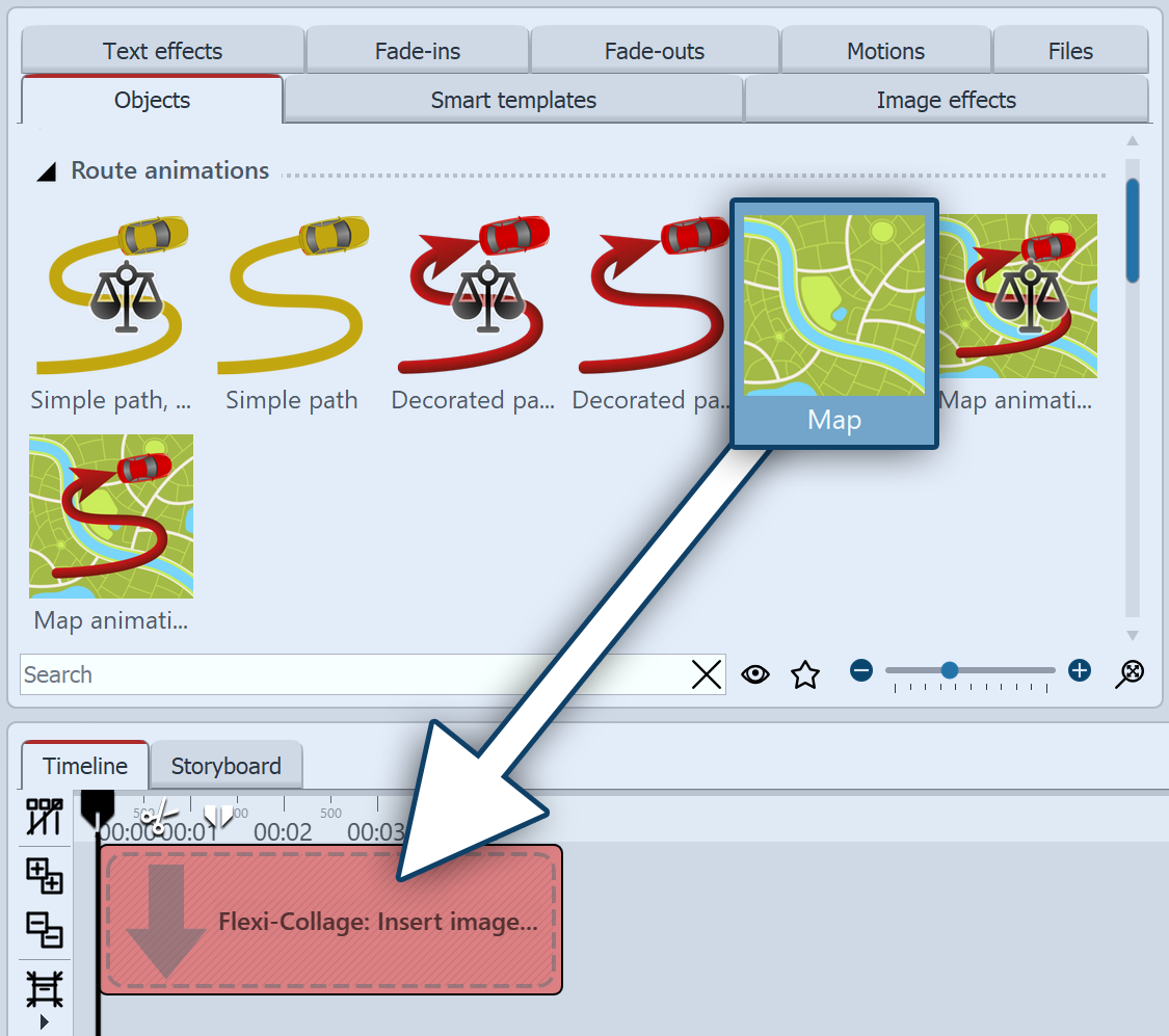

Now pull a map from the route animation field into the Flexi-Collage. This will immediately open the Map Wizard.
Select the first map section. Consider in advance, from where you would like the collage to begin. You could, for example, cover the lower left area with your map section, then the lower right and finally the upper section, if you want to compose your collage of four parts.
2 Select further map sections
The map sections are arranged amongst themselves

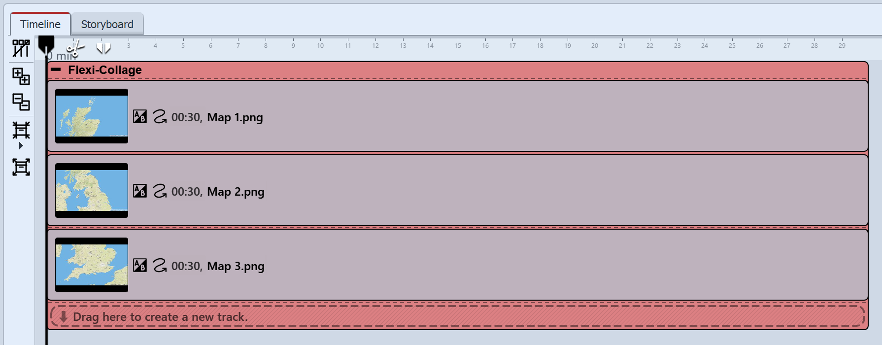

Add additional map sections by dragging a map into a new track, so that the map sections are arranged underneath each other.
In selecting the card members, make sure that the border areas still contain parts of the adjacent map piece, so that the map sections can overlap slightly.
After you have inserted all the map sections, lengthen their duration in the Properties field.

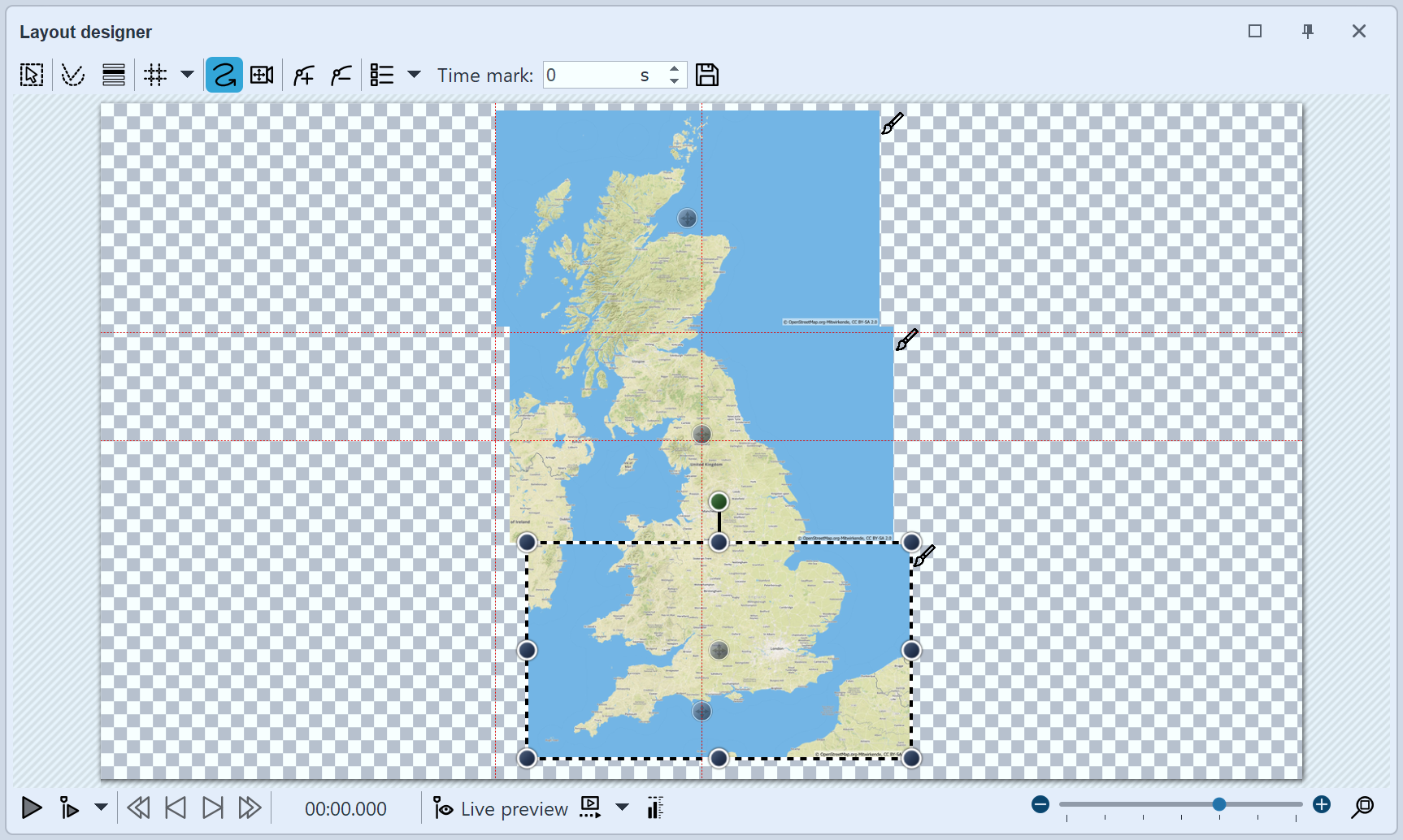

3 Combine map pieces in the Layout designer
Map sections are joined together
Map sections should be the same size
Map sections are joined together overlapping

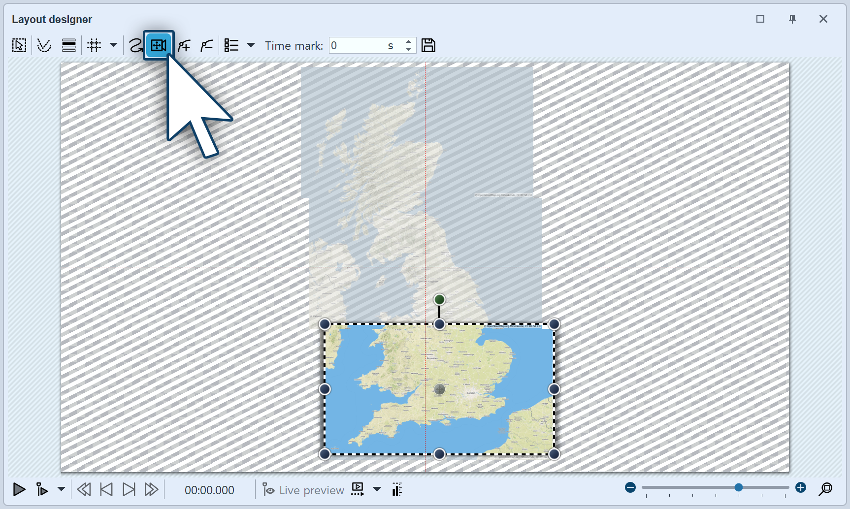

First, the map pieces are layered in the Layout designer so that you can only see one map.
Shrink all the maps and slide them roughly into position. It is crucial that all the map pieces are of the same size. The easiest way to do this is to shrink the first map piece and then right click on it in the Layout designer. Select the option copy path. Now click on another map piece to select it. Right click on it and select insert path.
Now you can move the maps, so that all the parts fit together well.
In order to be able to see well every detail of the map, you can zoom in with a held-down  Ctrl  key and the mouse wheel in the Layout designer or click on the plus magnifying glass icon.
4 Insert a route
The running line is situated in the lowest track
Drag a Decorated path into the lowest track so that the path animation lies in the Layout designer above the map parts.
In the Layout designer now determine the location of the points on the path, as described in the chapter "Inserting a decorated path".
Set a smaller width for the decorated path in Properties.
4 Straight edge with camera panning
LA_Map_Pan.psd
Determining an image's display detail

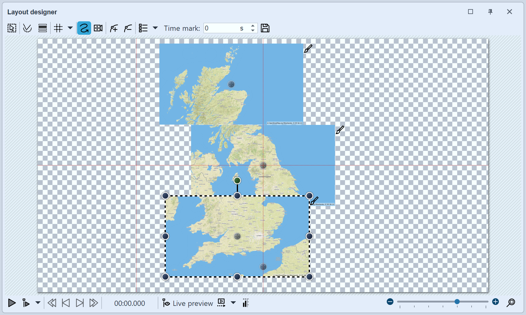

If you have arranged the map pieces in a slightly offset manner, you will see, that the map collage does not have a straight edge.
This problem can be solved by specifying a section of the map. To do this, in the Layout designer activate the camera panning mode. Click on the red edge of theFlexi-Collage and specify the section of the image with the sampling frame.

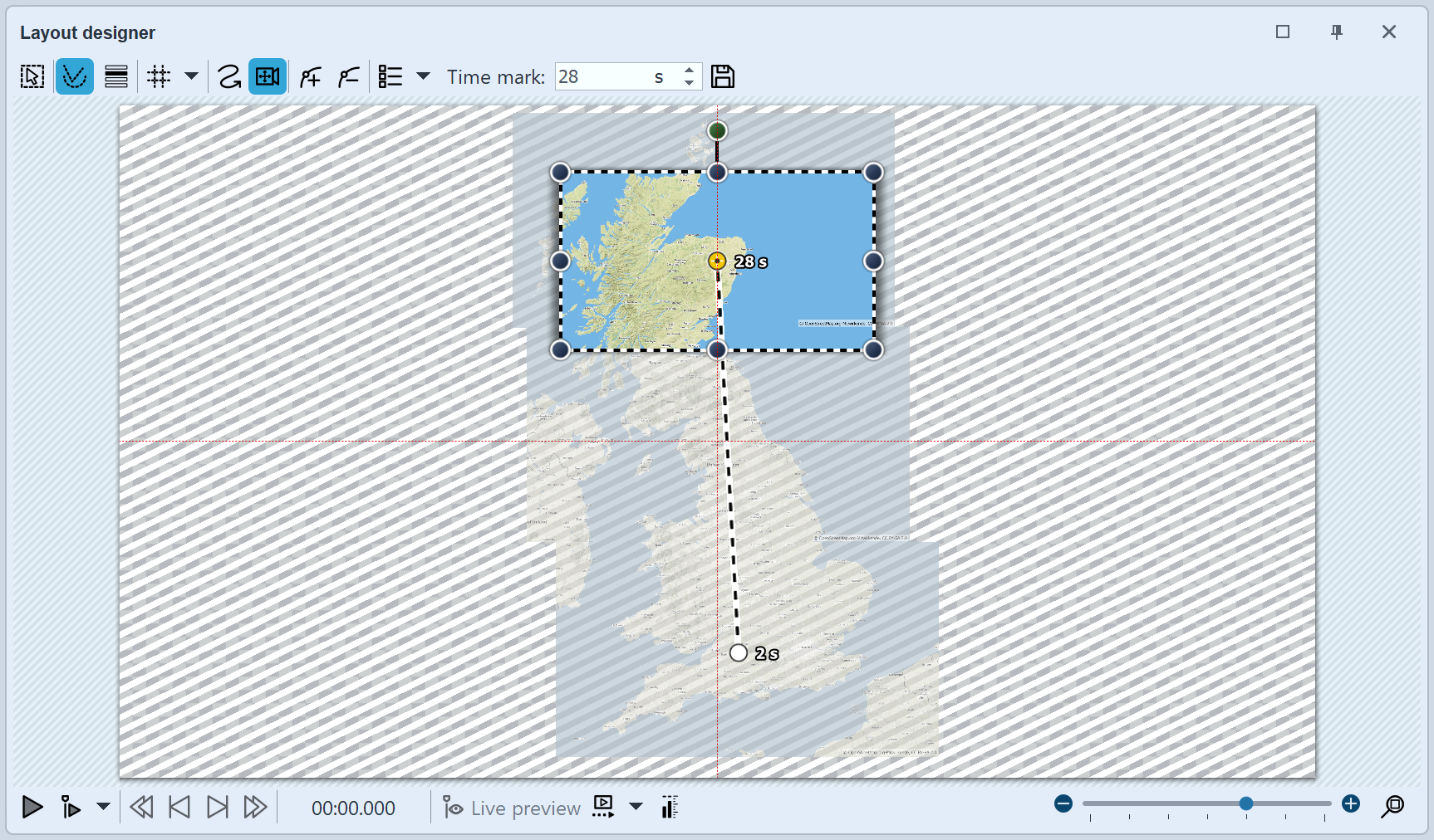

In camera panning mode, you can also set a tracking shot, instead of the image detail. It is advisable for this purpose to use a very small number of motion marks that for their part are not too small. If the map sections are too small, the tracking shot will be bumpy. Follow with the camera panning roughly the route of your animated path. If the route permits, e.g. Two motion marks are sufficient to mark the path.
Before you set the camera panning, adjust the path:
make sure that the length of the path corresponds with the duration of the map sections. If this is not the case, right click on the path and under edit path select the option adjust the duration. There enter the preferred duration of the path.
Click once more with the right mouse button on the path and select balance path, to achieve a uniformly smooth path.
Now you can set the camera panning.
