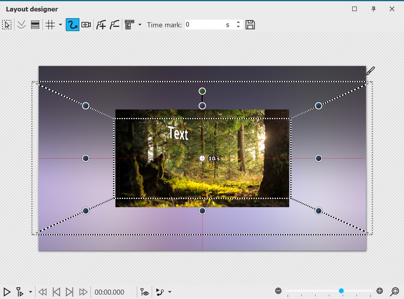

4 Motion path for 3D scene
Select the 3D scene in the Timeline. In the Layout designer, move the selection frame of the 3D scene smaller at one corner.
Add a motion mark and drag the selection frame of the 3D scene larger again. Give the second time marker the value 10 seconds.
If you play the project in the Layout designer, you will see how the 3D scene gets bigger from back to front.

5 Rotation for first mark
Click the frame of the 3D scene and enter a rotation on the Y axis of 10° at the first motion mark (0s).
Observe what happens during playback: The initially skewed 3D scene turns towards the viewer, we see the skewed floating text closer in front of us.
