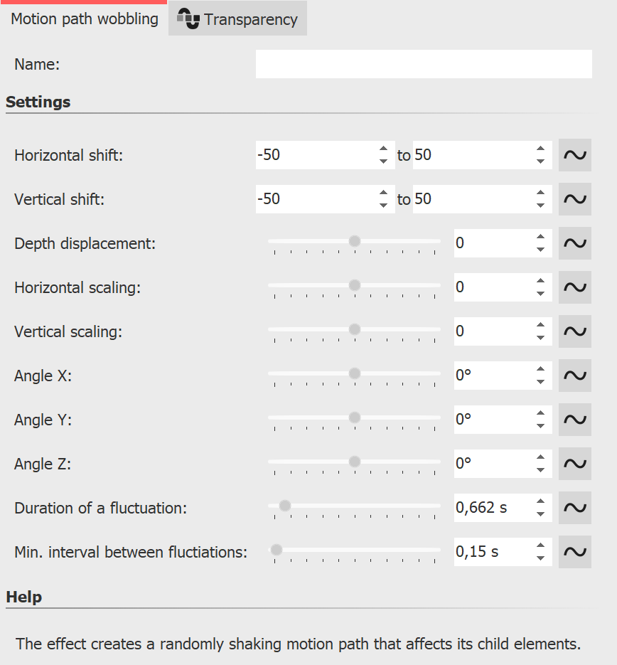

2 Features of the Motion path wobbling
Props_MotionPathWobbling
The Horizontal shift determines how much the deviation from the original path to the left (negative value) or to the right (positive value) should be. The Vertical shift determines the deviation upwards or downwards. The concrete shift is a random value between the two limits.
The Horizontal and Vertical scaling settings determine how much the size varies from the original object. The Angle setting lets you rotate the object.
How long a deviation should be before returning to the original path determines the Duration of a fluctuation. If the movement should be rather small, you can set a pause between the wiggles with the Minimum interval between fluctuations.
