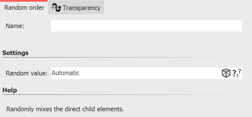

2 Settings for "Random order" effect
After you have inserted the effect, click on the colored effect frame in the Timeline. In the Properties area, you can now see the adjacent properties.
If the Random value field is set to Automatic, the order in which the content is shown will be decided each time the effect is played.
With the Dice symbol you can also create a code that fixes the playback with the diced value. This selection is then retained for each playback.
