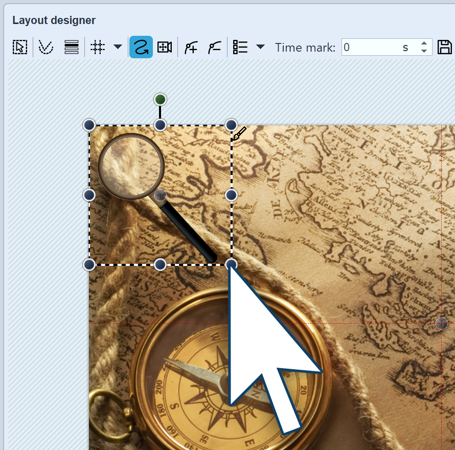

2 Zoom out
Shrink the image in the Layout designer
Since the magnifying glass is still reasonably large, you can shrink it to allow more room for movement.
To achieve this, click on one of the round drag points and use the mouse to drag up and left.. The image should now be smaller.

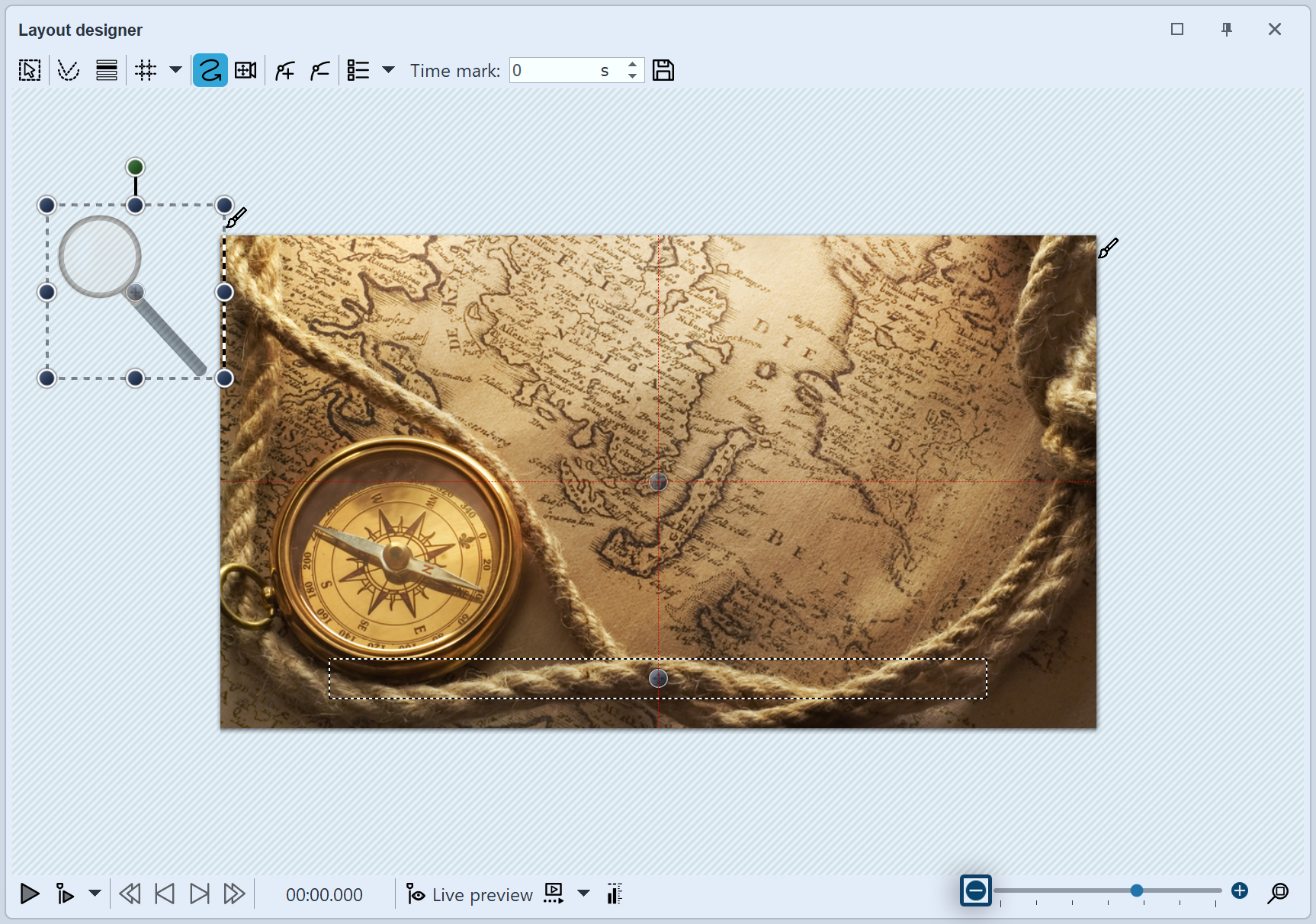

3. Positioning of the first motion marker
The magnifying glass should travel across the image from left to right. In addition, the non-visible range is used. To get better access to this, zoom out by clicking the Minus icon in the lower Toolbar of the Layout designer. Now drag the image to the left side of the non-visible area. This is the first motion mark.
The first movement mark is located in the non-visible area

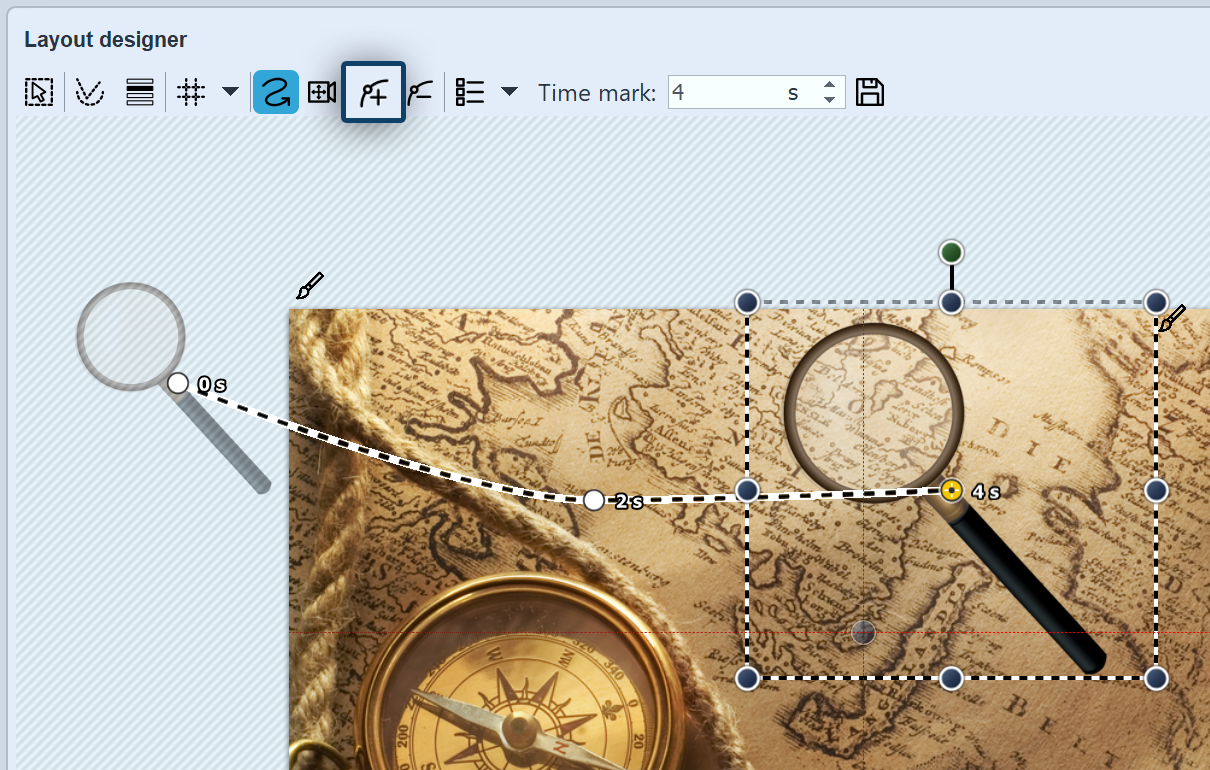

4 Enlarge new motion marks
Creating new motion marks
Now create the next motion mark with the Plus icon. The magnifying glass moves to the right and becomes larger.
Again use the mouse on the round drag points to drag the image slightly larger.
With the Plus icon, insert further Motion marks. Enlarge or reduce the graphics now for each mark.
5 Complete the motion path
With the Plus icon insert further motion marks. Now enlarge or reduce the image by a small amount for each mark, depending on how it fits best.
