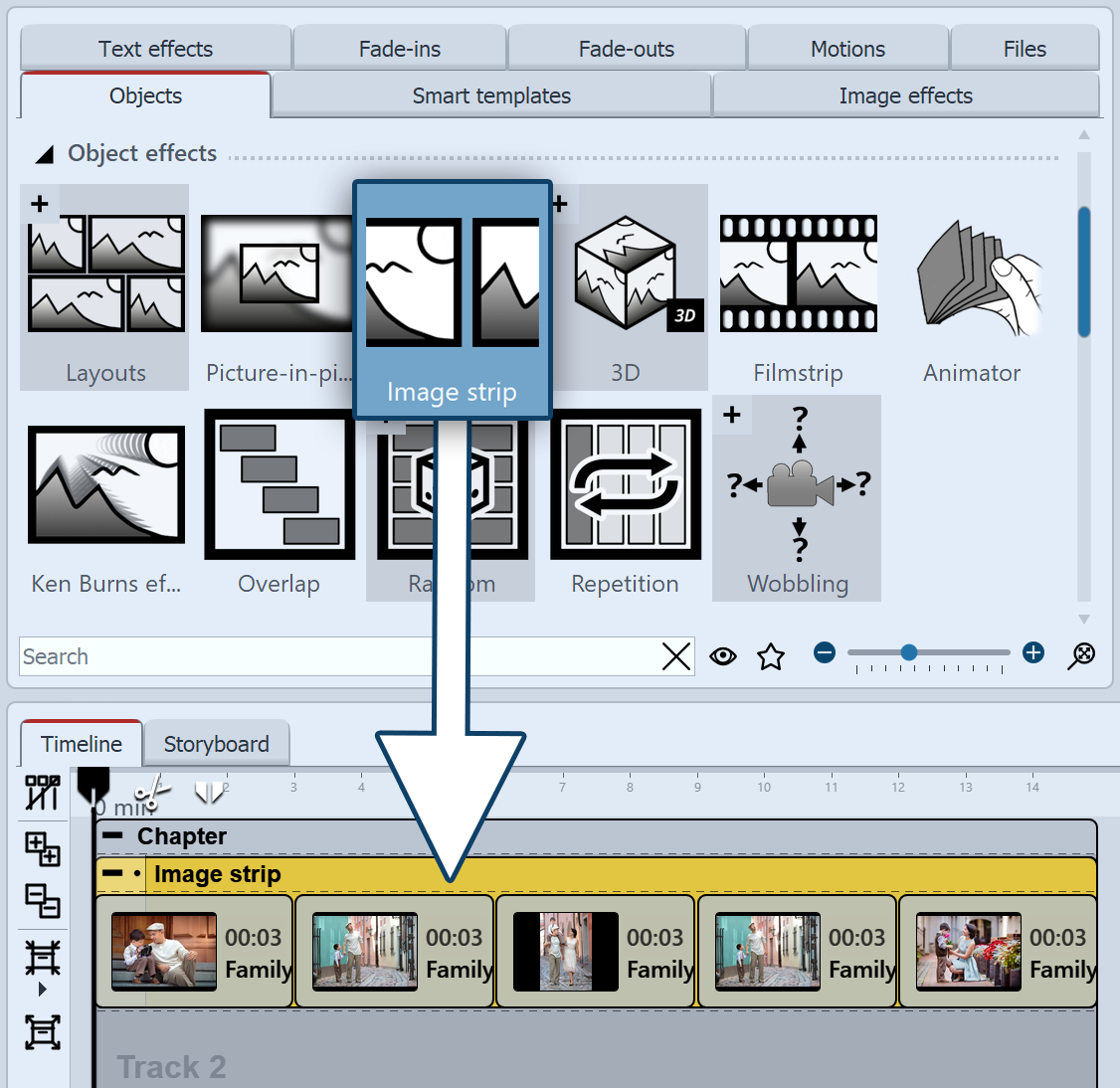

You can find the effect in the Toolbox under the Objects tab in the Object effects section.
1 Insert an "Image strip"
Image strip in the Timeline
Drag the Image strip effect from the Toolbox to the Timeline. In the Timeline you will now see a colored box. Insert your images here. Fetch the images, for example, via the Toolbox tab Files into the Timeline or drag an Image object into the Image strip effect to insert the images.

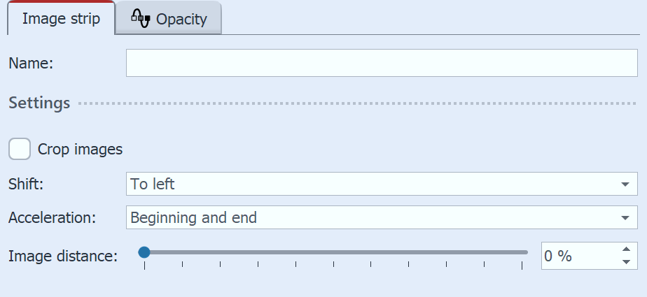

After you have inserted the images, click on the colored frame of the Image strip effect in the Timeline. In the Object settings area you can now set the shift to (running direction) of the images.
With Acceleration you decide whether the Image strip should run at a steady speed (selection "none") or appear slowed down at the beginning and/or end. You can also set whether an Image distance should be inserted or how large this should be.
Furthermore, you can choose whether the images should be cropped. Always select this option if your photos do not match the aspect ratio of the project.
