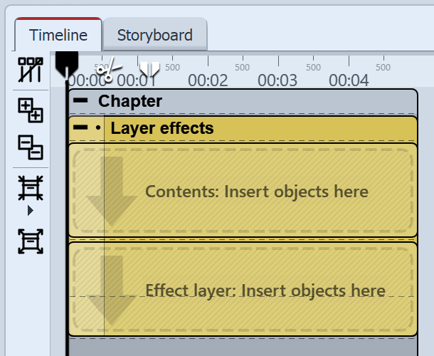

Drag the effect from the Toolbox into the Timeline.
In the effect you will find two areas: Content and effect level:
In the content field, drag the object to which the effect is to be applied.
In the effect level field, put the image or video, with which you wish to describe the up and down of the effect.
The more contrasting the darks and lights are here, the better the appearance of the overall effect. You can assign individual effects to all the objects which are in this effect, for example, a motion path.

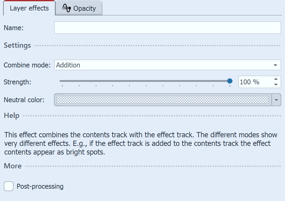

Depending on the Combine mode you choose, the appearance of the effect affects the content.
With the Strength slider you can set how strong the effect is.
Combination mode
Effect
Adding
The lighter the areas of the effect layers are, the lighter the areas of the content levels will appear.
Subtracting
Depending on the color information of the effect level, the mixed color are subtracted.
Shadow
Integrates the alpha channel and shows half-transparent areas as darker. Depending on the color information of the effect level, the mixed color are subtracted.
Lightening
Integrates the alpha channel and lets the half-transparent areas glow. The lighter the areas of the effect layers are, the lighter the areas of the content levels will appear.
Multiplying
Patterns and colors of the effect layer overlay the content level, where the highlights and shadows of the content area remain.
Minimum (darkening)
Shows areas in the alpha channel as darker. Bright areas of effect level are highlighted.
Maximum (lightening)
Shows areas in the alpha channel as lighter. Bright areas of the effect level are highlighted.
Light colors
Stronger separation of light and dark, as in adding.
Darker colors
Stronger separation of light and dark, as in subtracting.
Adjustment
Strength
The extent to which the effect is to affect the content.
Post-processing
If this option is enabled, the effect will work on everything that is hidden by the effect frames in the Timeline.
