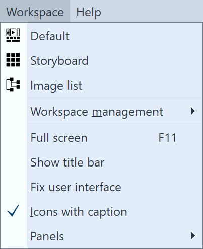

Selection of workspaces
Selection of workspaces in the menu and in the Toolbar
In AquaSoft Photo Vision and Video Vision, you will find three and four preset options for arranging the user interface in the Workspace menu, respectively, and five in AquaSoft Stages. In the Toolbar you will find the respective options as well.
In most of the instructions you will find in this manual, the Default workspace is used. However, this does not mean that this must be the best workspace for your purposes.

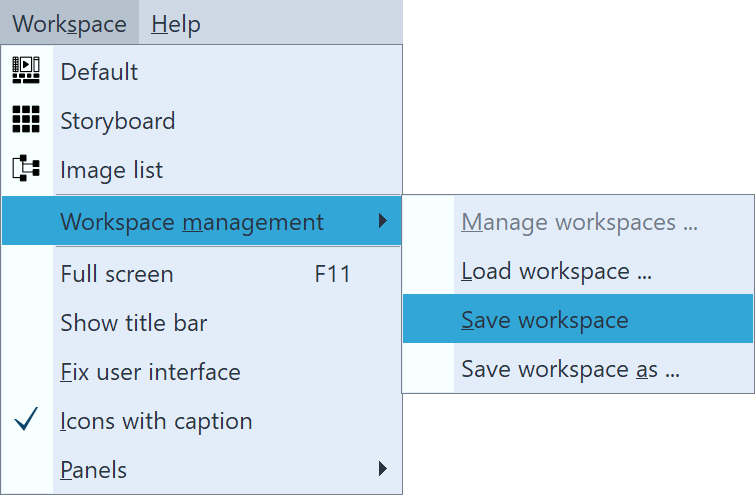

In addition to the already existing workspaces, you can also create and save a workspace yourself. To do this, arrange control elements of the Program interface according to your wishes, this is done via drag-and-drop. Under Workspace, select Workspace management / Save workspace. Now enter a name for the self-created workspace.
If you want to call up an already saved workspace, select Workspace / Workspace management / Load workspace. Now select the desired workspace.

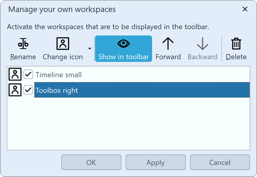

To display the saved views with icons in the Toolbar, go to Workspace / Workspace management / Manage Workspaces...
If you mark a custom workspace with a check mark, it will be  displayed with an icon in the toolbar. Apply the selection  to the program using the Apply button.
In this menu you can also
- rename the views and add a description to them, which is displayed as a tooltip
- set a different or own icon for the workspace
- change the order of your own workspaces
- delete workspaces.

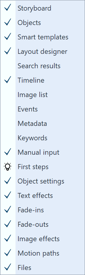

Under Workspace / Controls you can activate additional controls, such as the Metadata, which can be displayed in the program interface or on a second screen (if available).
Place a check mark in front of the control to activate it. To make the control disappear, you can either close it or remove the checkmark from the Workspace / Controls menu.
If the Developer mode is active under Extras, further controls are available for selection.
