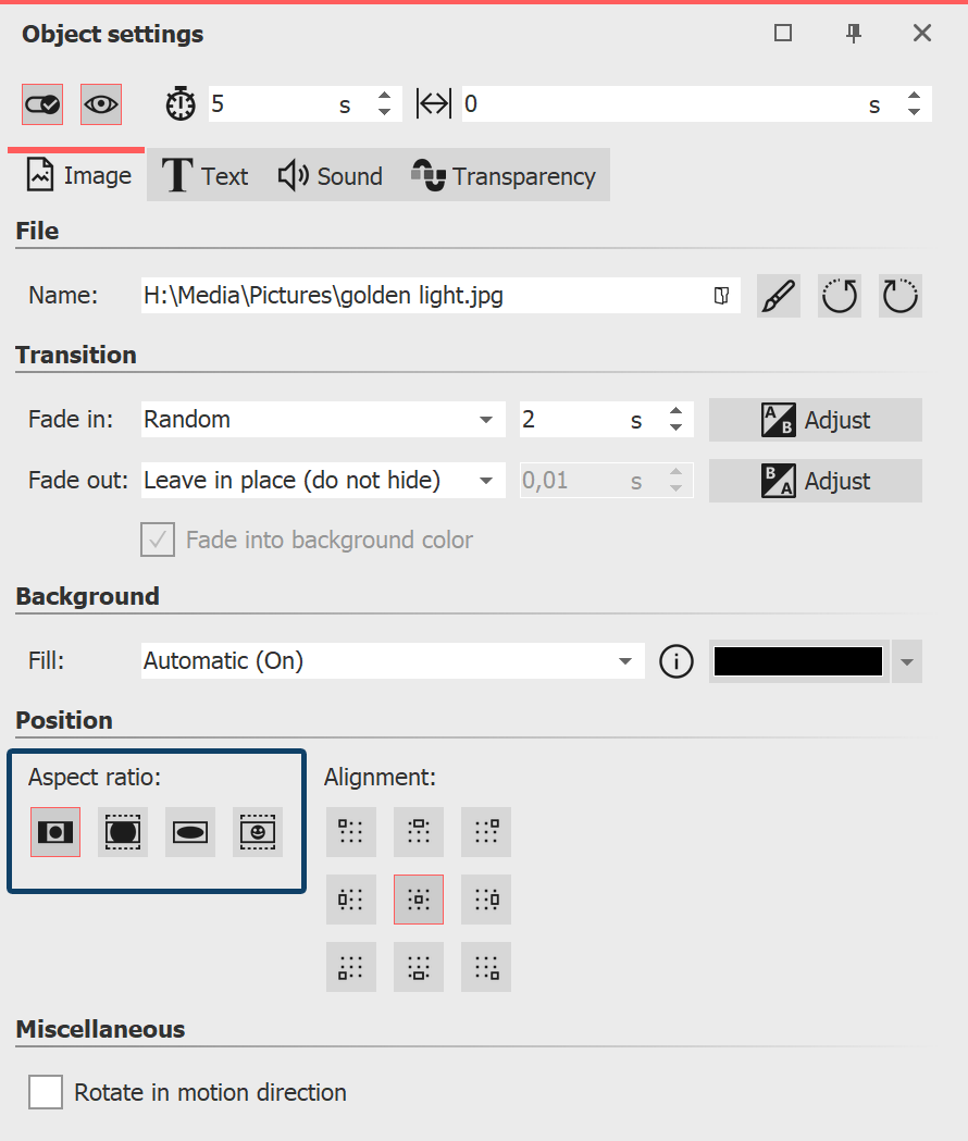

In the Properties window, under Position / Aspect ratio, you can make various settings to automatically adjust the aspect ratio of your photo to the aspect ratio of the project.

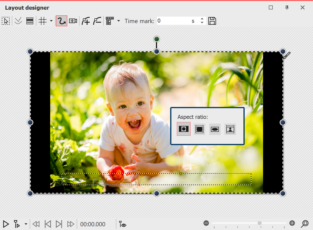

The following options are available for an image or video:
Btn_Image_Keep
Keep - The image keeps its aspect ratio. If it is different from that of the project, black borders will be displayed.
Btn_Image_Crop

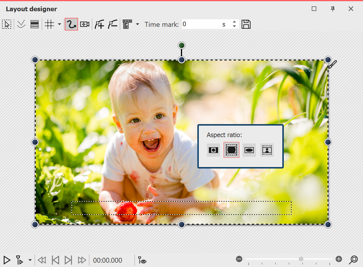

Crop - the image is cropped at the edges so that it has the same aspect ratio as the project (the original file is not changed, only the display of the image in the project is cropped).
Btn_Image_Stretch
Stretch - The image is compressed or stretched to fit the aspect ratio of the project. This is not suitable for images of people, as they may acquire an unnatural or unflattering figure.
Btn_Image_CenterFaces
Center faces - the image is cropped at the edges so that it has the same aspect ratio as the project (the original file is not changed, only the display of the image is cropped). Faces are taken into account when cropping (face detection) so that they can be seen as completely as possible.
You can use the Alignment buttons to influence the position of the image on the screen or to specify the area of the image to be cropped when "Crop" is selected. The center position corresponds to "Centered".

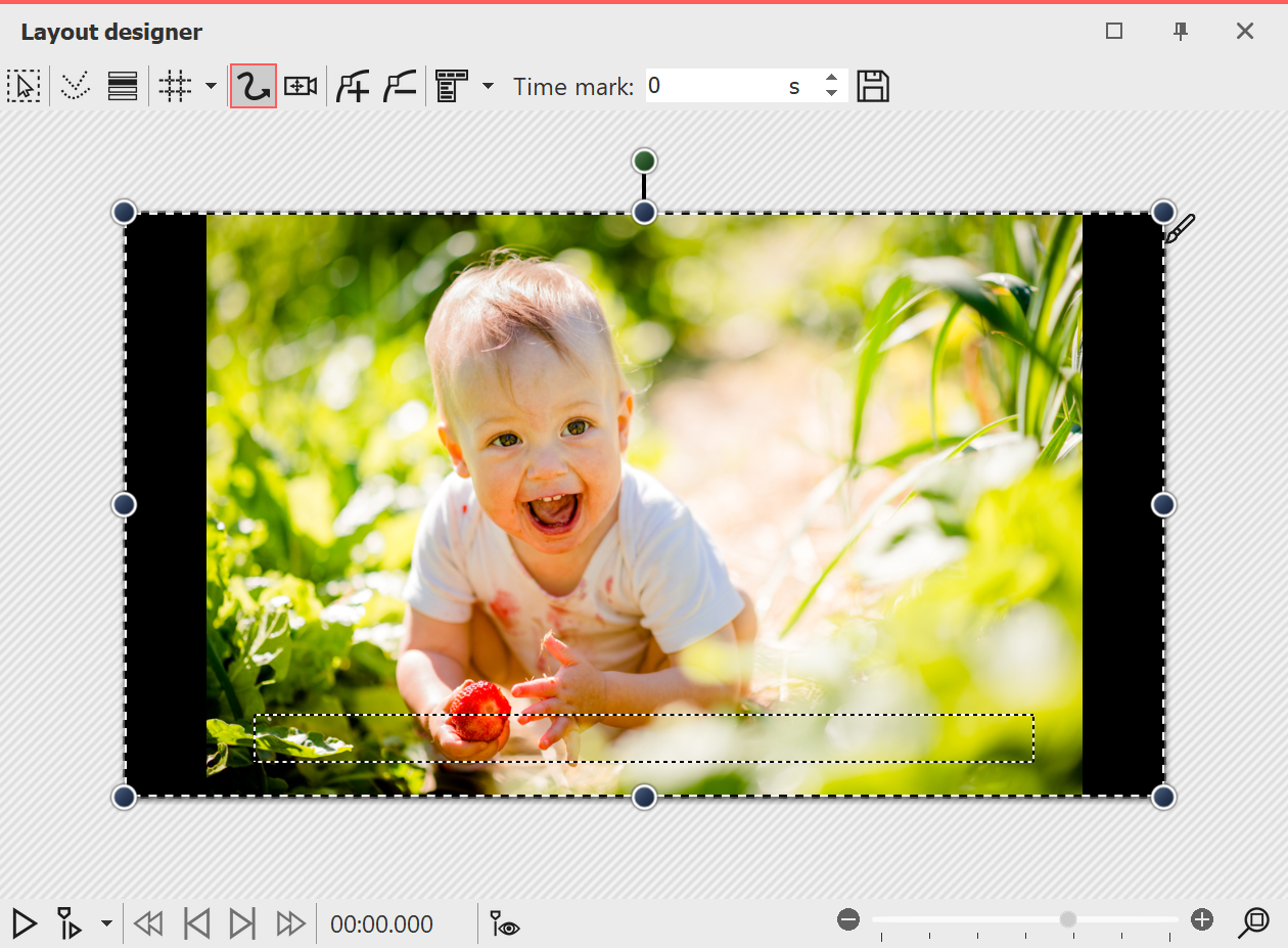

Image in 16:9 project with "Keep" aspect ratio
Image in 16:9 project with "Crop" aspect ratio

Image with black borders
Image with black borders left and right

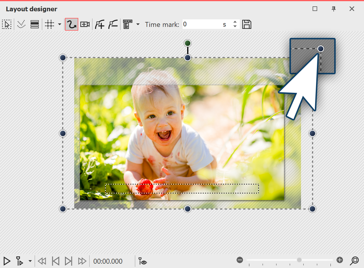

Manually enlarged image
Enlarge image in Layout designer
Reduce the size of the section in the Layout designer by clicking the Minus symbol LABr_ZoomOut at the bottom right of the Layout designer .
Drag the image larger using the corner points of the Position frame until the black borders have disappeared. Then position the desired image section in the visible area.
Alternatively, you can also Define a section of the image with a camera pan.
