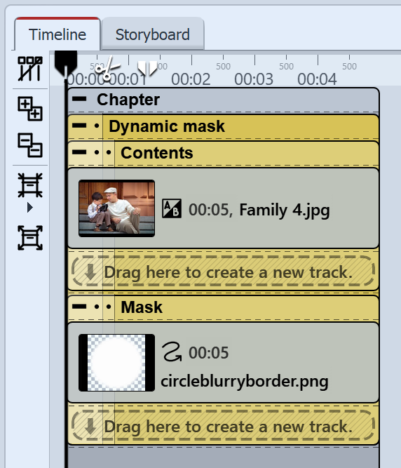

1 Insert the "Dynamic mask" effect  VIDEO VISION   STAGES
Dynamic mask effect in the timeline
Drag the Dynamic mask effect from the Toolbox into the Timeline. Should the effect not have opened as per the example picture, you can click on the small plus, that is located in front of the lettering Dynamic mask effect in the Timeline.
Now you will see two fields:
Content: Here you add the objects on which you want the mask to have an effect.

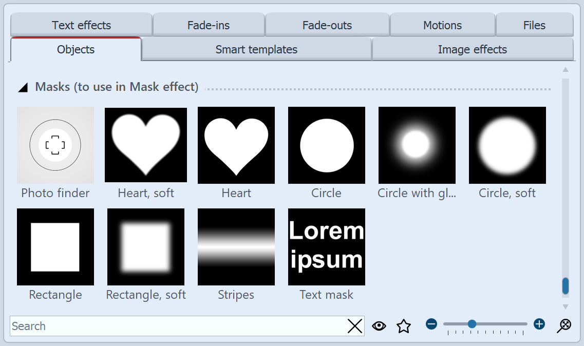

Mask: You insert the mask here. For this you can use ready-made graphics from the Toolbox, which you can find under the tab Objects tab in the Masks section.

Masks from the toolbox

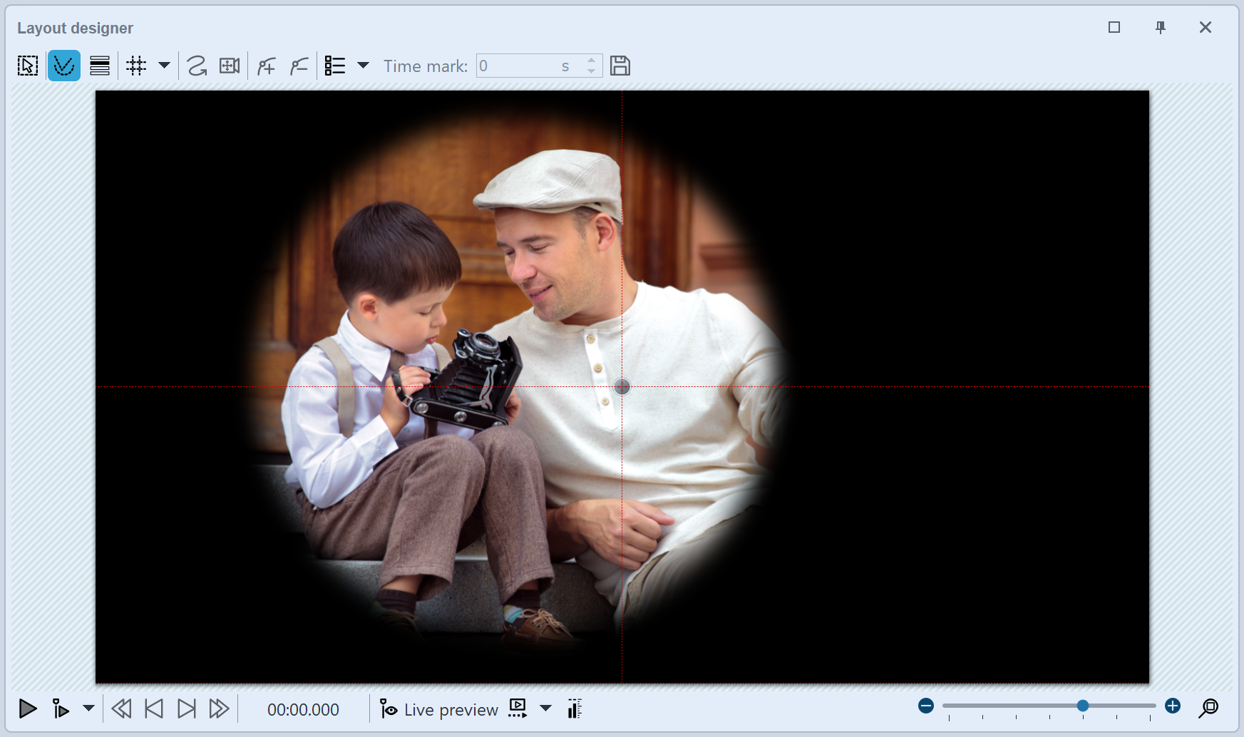

A mask has a white and a black area. The area which in the mask is white, leaves visible the object which you have inserted under Content.
The black (or also transparent) part of the mask hides the object that you have inserted under Content.
There are several display options, help you to place the Dynamic mask effect properly.
Yellow frame of the effect has been clicked on
The yellow frame of the effect has been clicked on:
In the Layout designer will only display that content which the mask has let through.

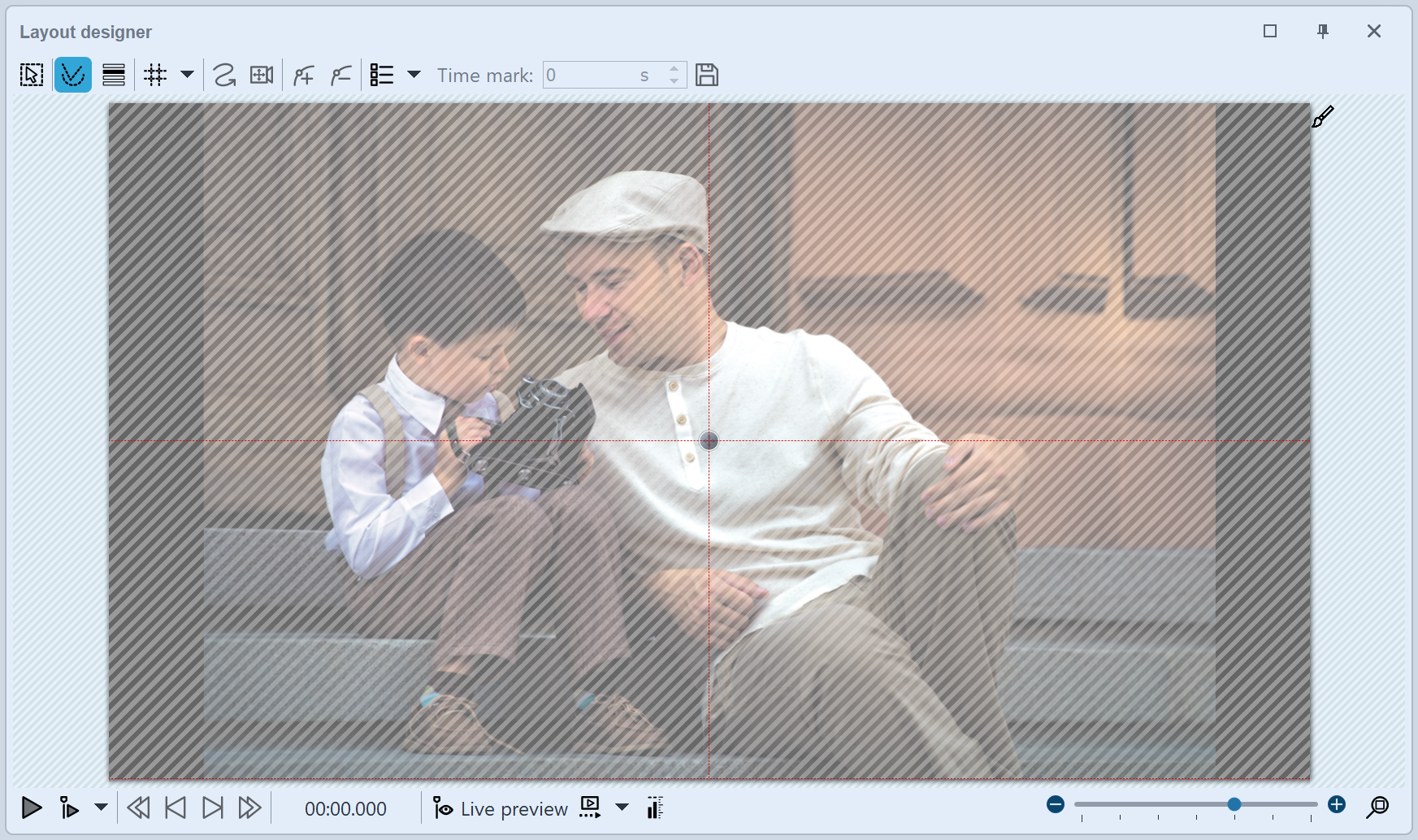

Content area of the effect has been clicked on
The content area has been clicked on:
The entire image is visible, but covered by cross-hatching.

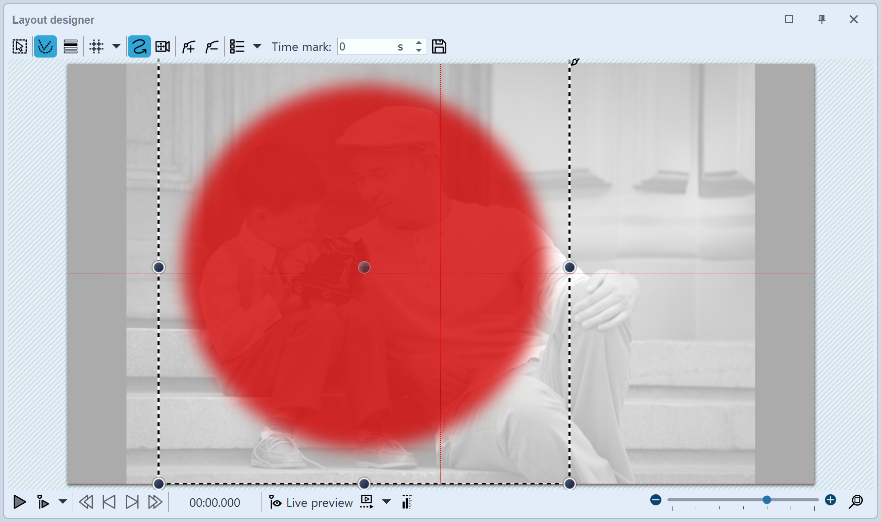

Mask area of the effect has been clicked on
Clicking on the mask area:
The image appears pale and black and white. The area lying above the permeable section of the mask is shown in red.

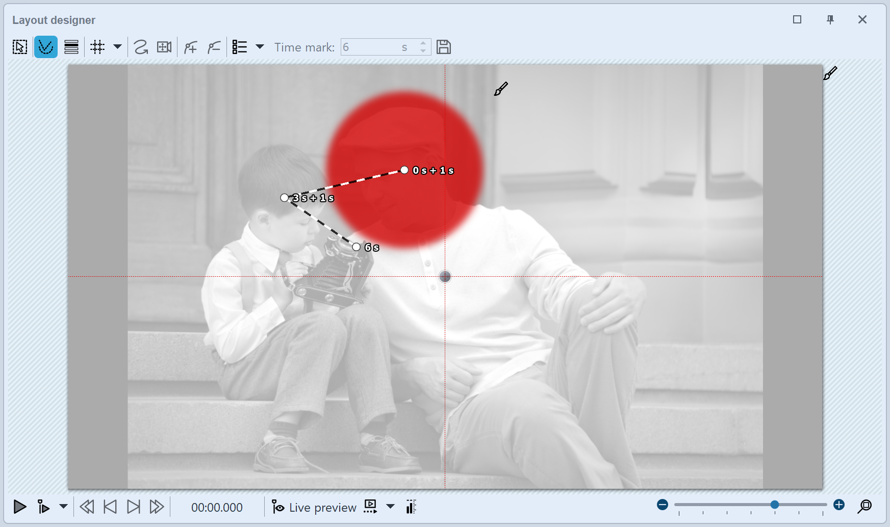

3 Move the mask
Mask receives motion path
You can add, to each element of the Dynamic mask effect a motion path and a fading in or out, and camera panning can also be used. Select the image that you have inserted into the mask field. In the Layout designer you can now create a simple motion path for this purpose. For information on how to do this, refer to the chapter "Introduction to motion paths”.
You have just created your first Dynamic mask effect. You can look at the effect in the preview in the Layout designer. There are many more possibilities - in the next step you will learn about another of them.

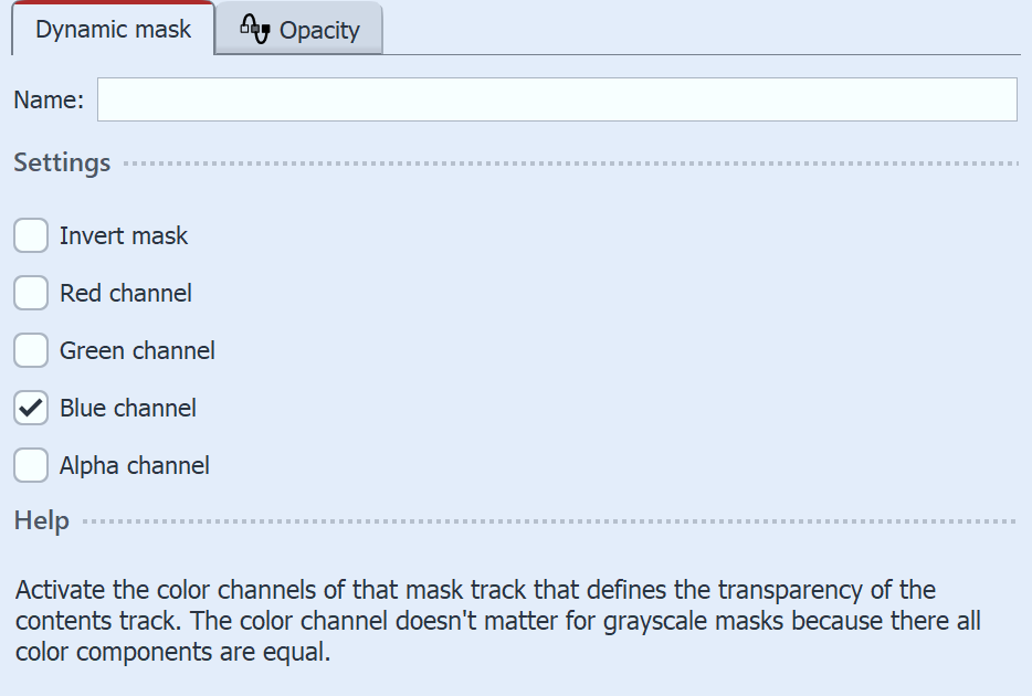

5 Settings of the effect
Settings for the Dynamic mask effect
Settings for the "Dynamic mask" effect
If the entire Dynamic mask effect is selected, find further setting possibilities in the Properties window.
Name
Enter a name here, so that you have a better overview later on
Rotating the mask
Inverting the effect of the mask so that visible areas become invisible and the other way round
Red, green, blue, and alpha channel
Masks do not have to consist of gray scale, but can also be colored. With the controls you influence the various channels.
